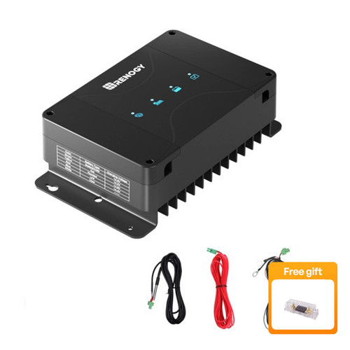

Also if you bought a dual dc to dc/mmpt they trickle charge the car battery of the solar once the house battery is full.
I have both the redarc and renogy and they both have this function.

There are multiple models with different amperage. I have used both and they both function well. Redarcs are about half the size of renogy but double the price.
I’m sure there are other company’s that make them as well.
Just a heads up, the Renogy has a solar input voltage limit of 25 volts. I recently upgraded from a 100 watt Renogy solar panel to a 160 watt Overland Solar panel and found this out the hard way. New panel output is 29-32 volts so I ended up swapping back to a Victron solar charge controller and a Victron DC-DC charger.
I do miss the starter battery being topped off like it was with the Renogy hence my interest in this thread as I too have an AGM starter battery and LifePo house battery.
