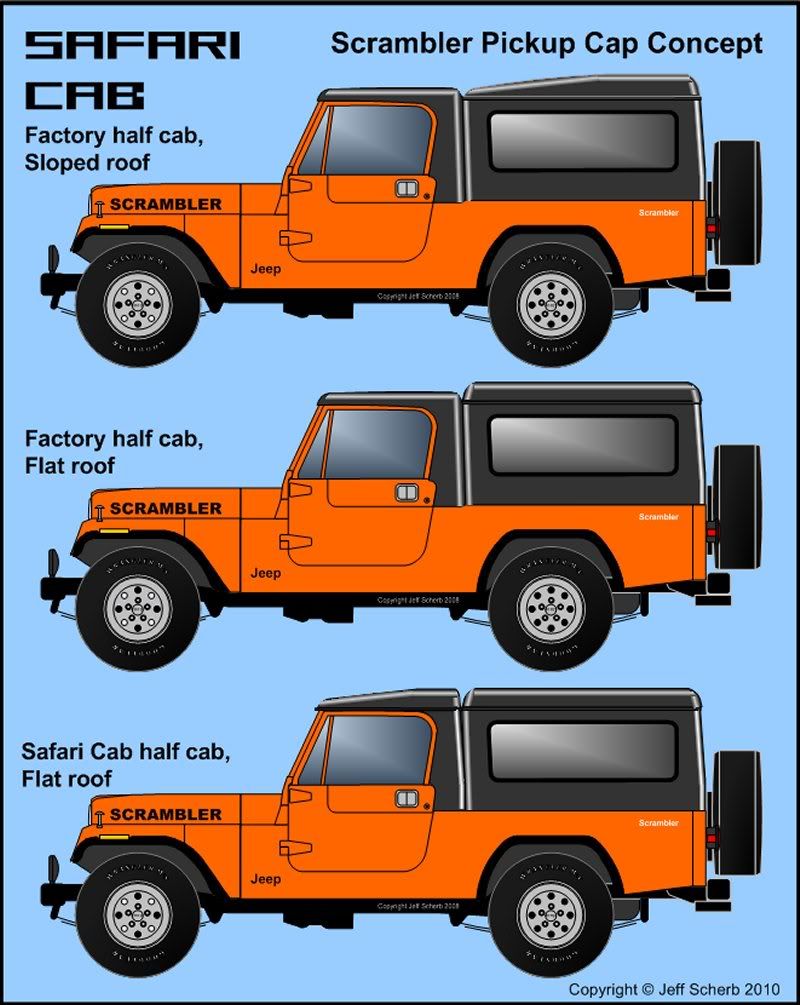

Actually Jeff I was thinking of a camper shell type deal for the scrambler with the factory half cab, and I do like the alpine roof line with the windows up top. would that be doable with the existing molds?
Terry,
Here you go, three Scrambler pickup cap concepts based on the Safari Cab, all using the existing molds (well, would required a new front wall mold, but all the other parts could be made in the existing molds)...
The top one is the factory Scrambler half-cab with the Safari Cab sloped-front roof; for the second one I've molded the roof flat, and for the third one I've swapped the factory half-cab for the slightly taller Safari Half Cab.
Not sure what type of window(s) to put in this one, so I just did one large side window.

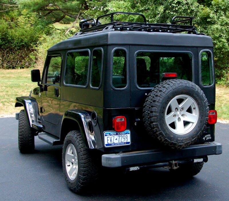

JS...
Looking at the back view of the hardtop...Are the little windows taller than the tailgat window or am I optically dillusioned??
jscherb
JS...
Looking at the back view of the hardtop...Are the little windows taller than the tailgate window or am I optically dillusioned??
Yes, the side "opera windows" are slightly taller. The reason for that is the structure of the inside of the barn door does not let the window go as high as the opera windows. The opera windows match the height of the side windows though. It's very common, the old CJ-2/3 hardtops were the same way, so was the Toyota FJ40:

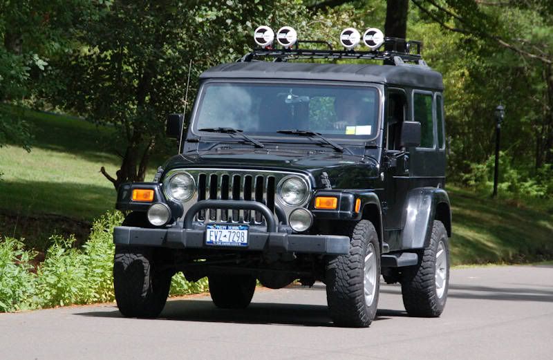

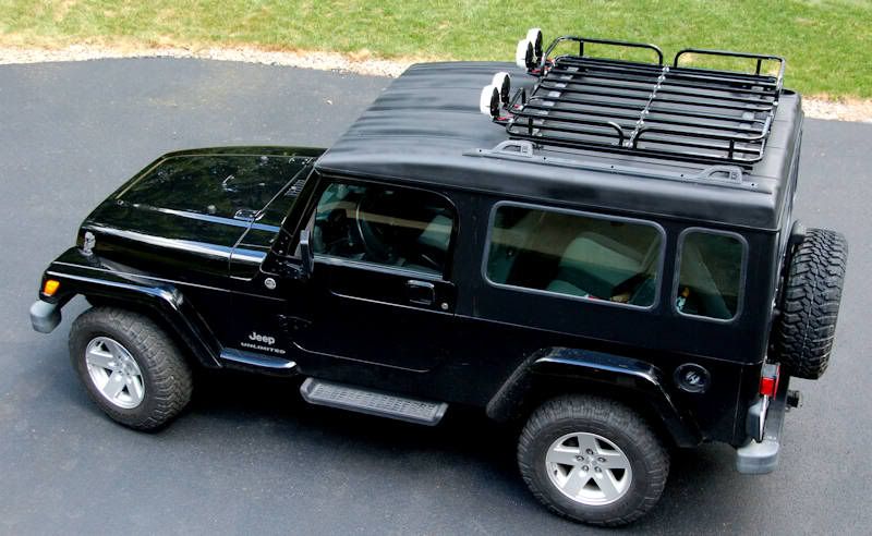

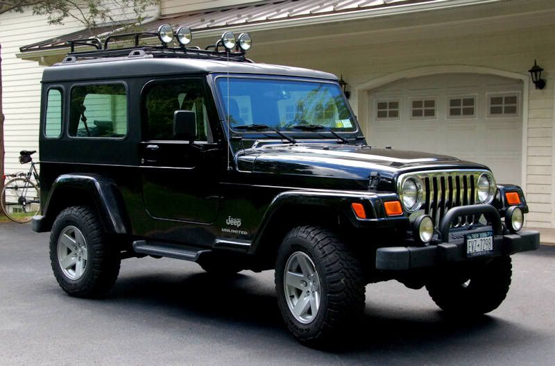

How about I bring us back on topic with some more photos I took the other day when I finished building and installing the rack basket and lights...
