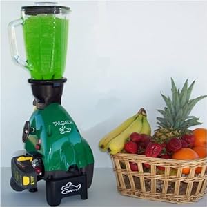

what about gas powered? no need for inverters or wiring, a little on the loud side, but what blender isn't?
http://www.amazon.com/Original-Tailgator-portable-gas-powered-blender/dp/accessories/B000WU5792
