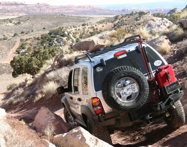

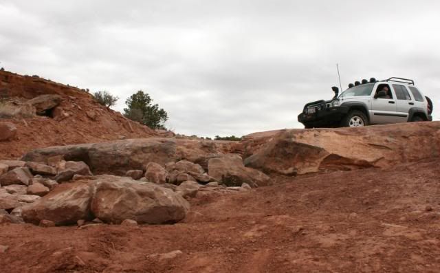

have to throw a couple pics of mine in of course
Custom lift 4 plus inches OME springs etc Rock Lizard roof Rack, rock rails, rear bumper ARB front, 4.10s 32 inch Duratracs/Moab wheels and other stuff :wings:
