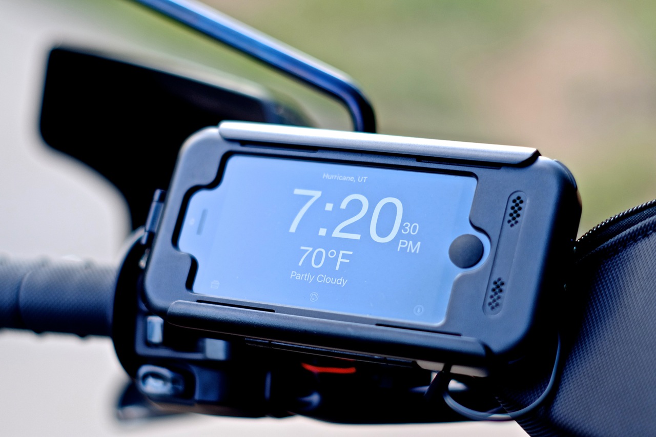

To start, a KLR handle bar bag was added providing a great spot for glasses and gloves and anything else you find yourself constantly putting on and taking off. Great design, though not quite waterproof.
To the left of the bag is a Tigra waterproof and shock-protected iPhone case and mount that I borrowed from my mountain bike. The case is a clam shell that seals with an o-ring with waterproof ports for power and headphones. The screen retains its touch sensitivity, even with my gloved hand. The device rotates 90 degrees and has a stout quick release feature. In my haste of sorting out my interface with the KLR, I ordered a RAM mount system for the iPhone without even considering what I had on hand. So the RAM system will be dedicated to the DeLorme inReach Explorer.

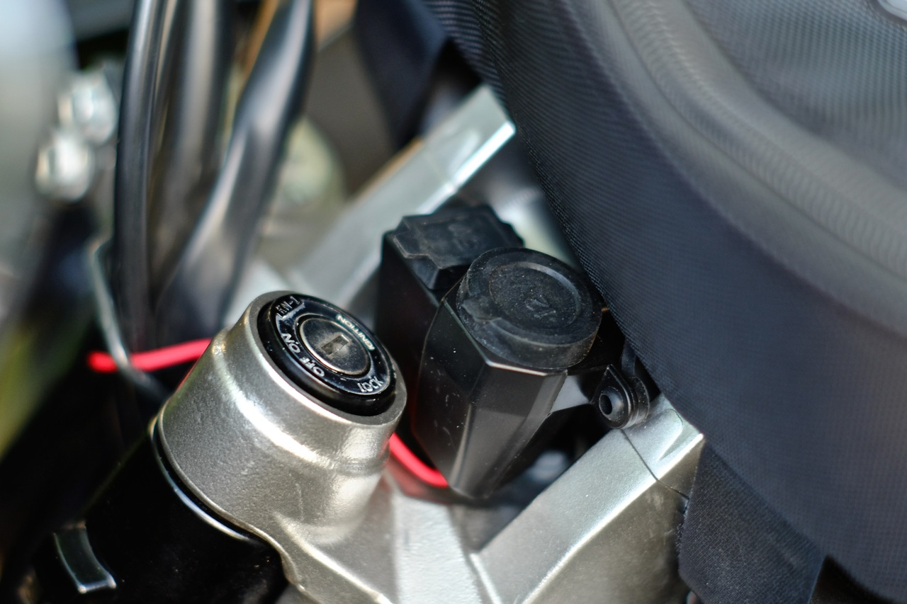

Charging the device and powering other 12V accessories is this RioRand 12V/5V socket and power port between the clamps underneath the handlebar bag.
I'm not crazy about its quality, but it seems to do the job so far. Both ports are sealed with rubber caps, but they feel like they'd disintegrate with a little bit of sunshine and where I live there's a lot.

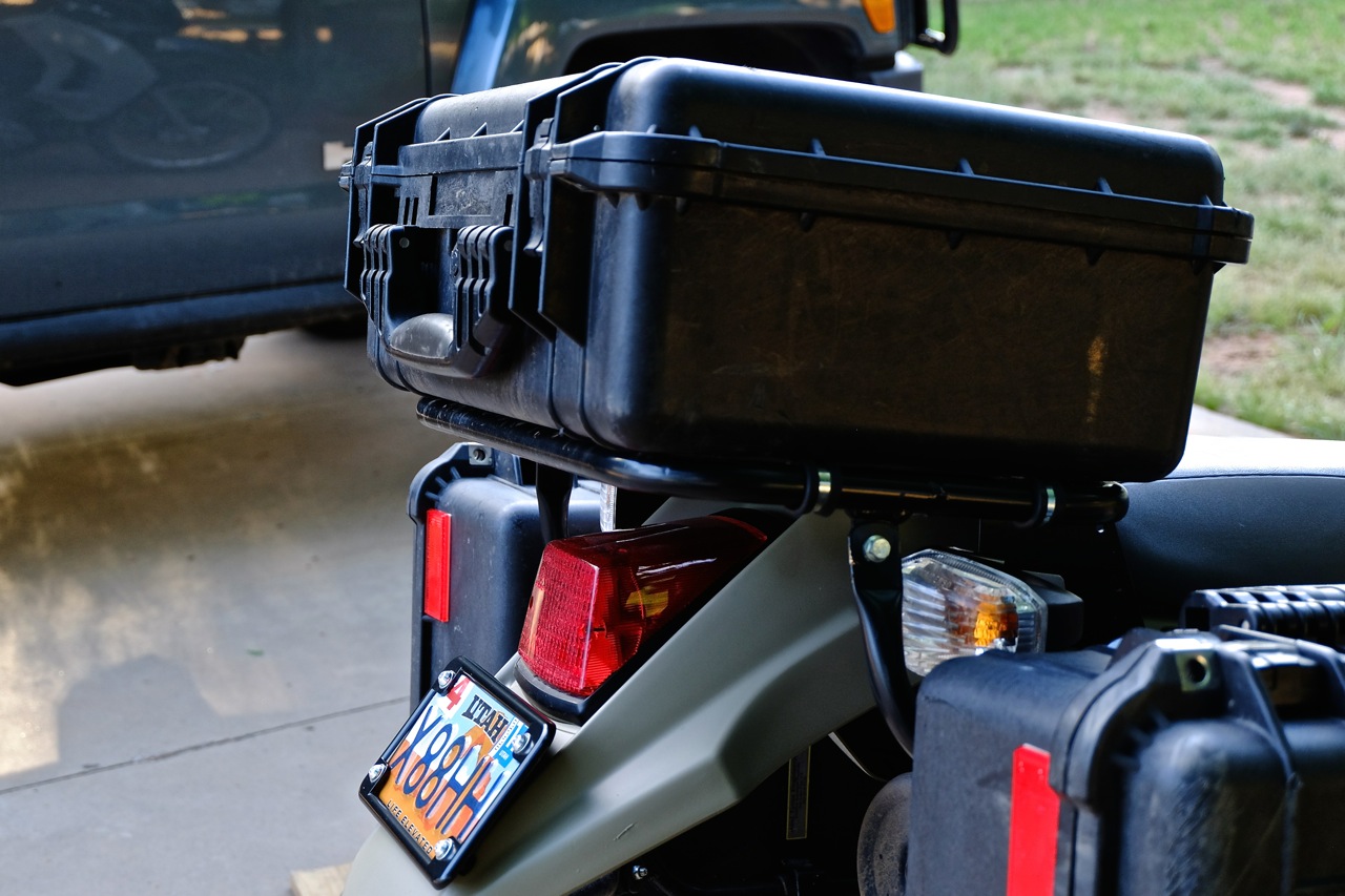

The last addition for this post is a Pelican 1520 top case. This was on the Montero and the H3 and held a breakaway cooking and mess kit.
This is now mounted on the top rack of the Caribou Case system adding a valuable go-to compartment to the panniers.

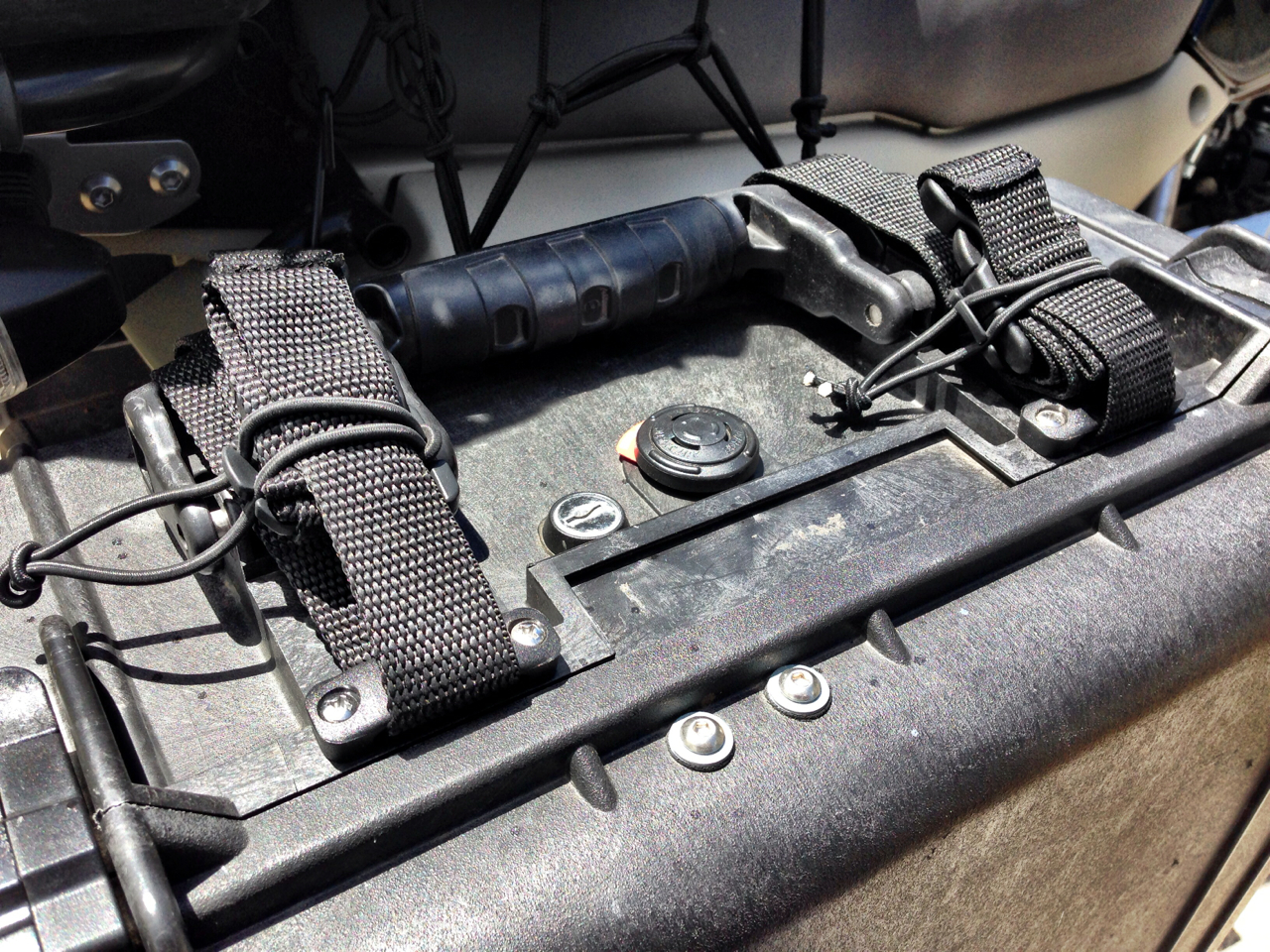

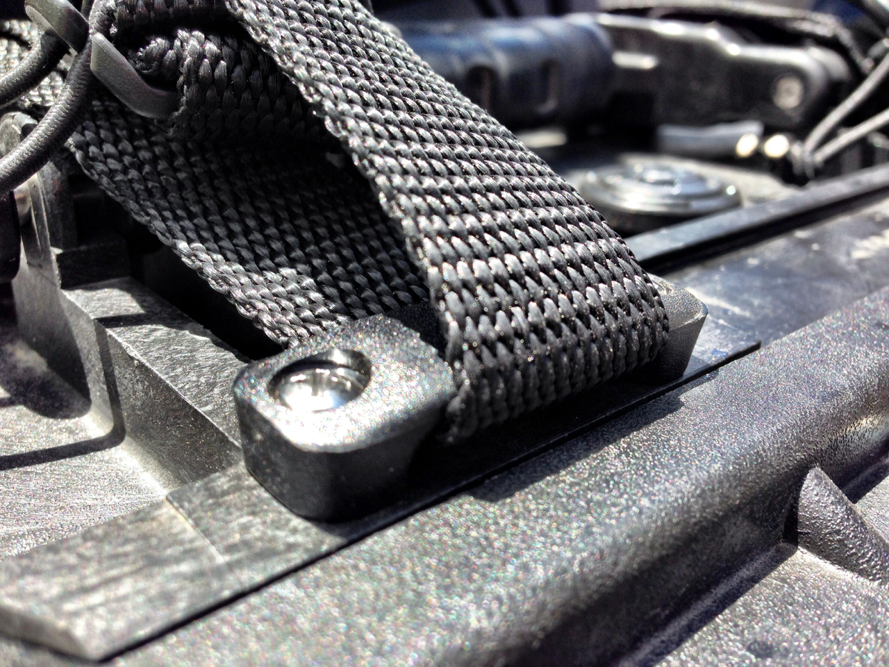

Transitioning on and off the bike is enough to make any rider stay on a little bit longer or ride past that vista without taking a shot. Jacket, earplugs or phones, brain bucket, glasses, gloves - then stow it away anytime you step away from your ride.
I thought I'd add a couple of details to make transitions a bit easier and handy.

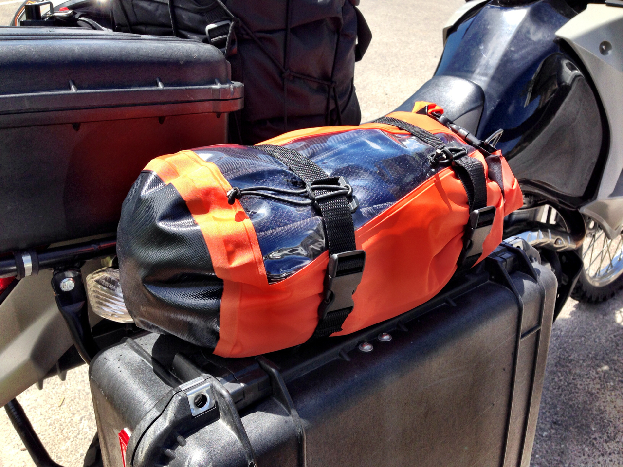

I added a strap system on the RH Pelican pannier to secure my camera bag and yet keep my device at the ready for a stop and shoot. Four black nylon Footmans loops were added to the top of the case through which are two one-inch straps sized to the circumference of the camera bag. The straps have quick release buckles and a couple of web dominators to mind the slack when they're not in use.
The camera bag (seen here inside a dry bag) lashes to the top of the case for a quick and secure mount, while having the camera easily accessible without having to dismount.

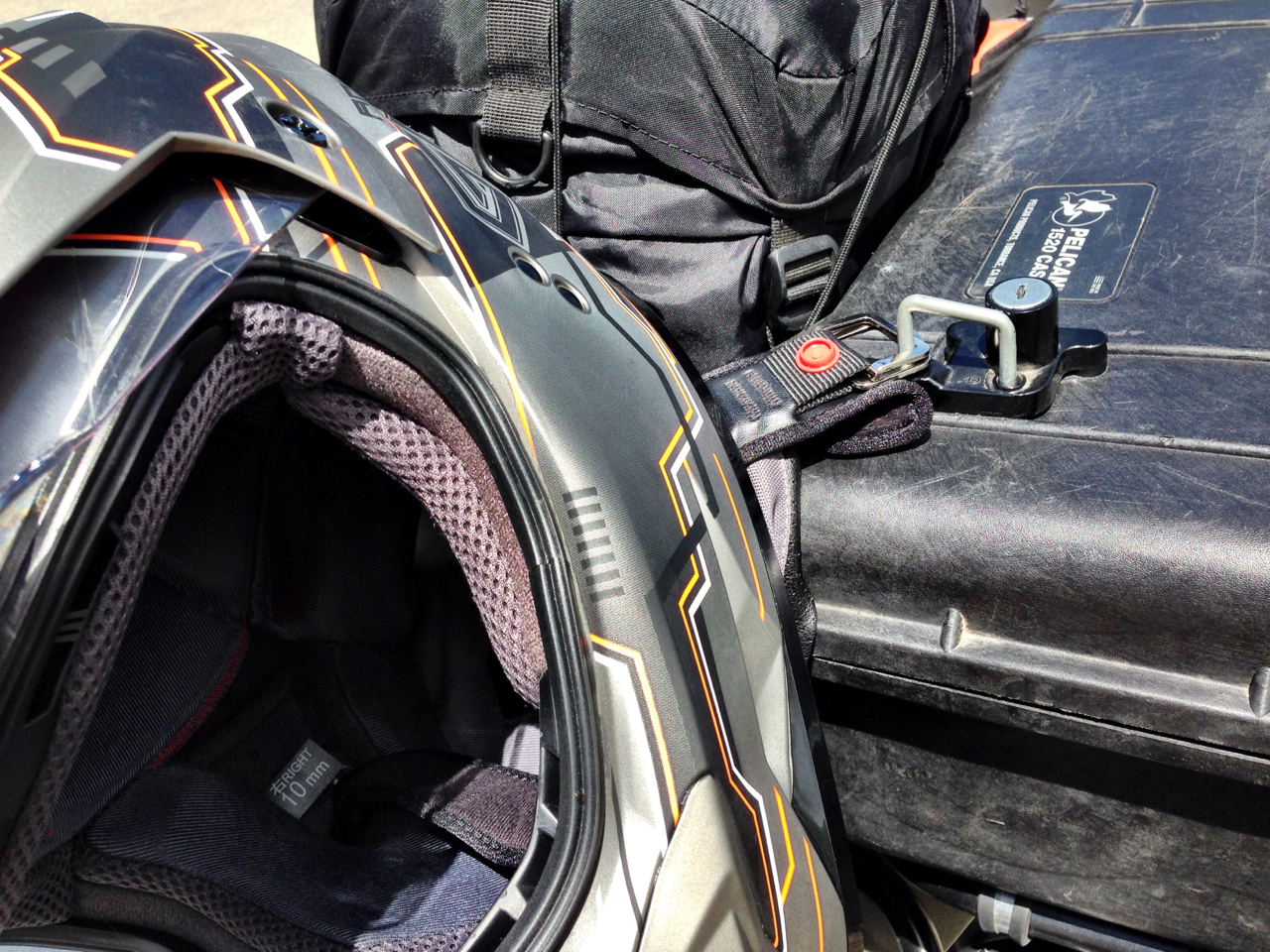

One more simple detail is the relocation of the helmet lock. Putting it on the Pelican top case to the side makes it easier to use, securing my helmet and jacket.

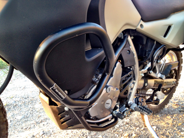

There are a number of aftermarket alternatives out there to remedy these issues and after considerable research I decided to go with SW-Motech products.
Much was said about their fit and finish, and the installations required no last-minute alterations or engineering to get everything to match up. And they were right.
The crash bars are powder coated 26.9 mm mild steel tubing engineered to mount at the top frame/subframe junction, the front engine mount aft of the skid plate and then on the bottom of the main frame forward the foot pegs. The accompanying hardware insulates the cage very well at the buzziest point of the engine mount. The precision of these mounting points speaks to SW-Motech's German engineering.

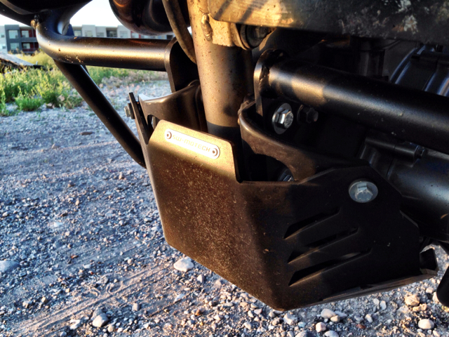

The SW-Motech skid plate is constructed from 4mm aluminum alloy, laser cut and bent to install with no wiggle room whatsoever. It looks much better than the black hockey mask from Kawasaki and appears to offer a bit more clearance. I haven't measured, it just looks higher.

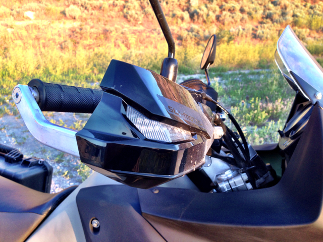

I was considering Barkbusters for the hand guards but found an SW-Motech Kobra alternative (so I thought) that allowed me to relocate my turn indicators to the handlebars freeing up the stock space for a pair of Trail Tech Equinox lamps.
I ordered the kit and received a stout pair of wind deflectors upon which mount SW-Motech's LED indicators that mount on Barkbusters' hardware.
Gone are the bar-end weights, but these ballasts are supplemented by the combined weight of the guards, though they're lighter. The Barkbusters come with an array of spacers and mounts to adequately clear levers. I found at freeways speeds the same stability I had previously, and on the dirt to have lighter, less lethargic steering response.
The LED indicators need a 10ohm resister installed inline (parallel to positive and negative feeds on both sides) to manage the extra wattage not consumed by the lamps. The blink rate is much faster without the resistors. I wired the indicator harnesses into the factory loom using off-the-shelf hardware that fit the SW-Motech connectors.

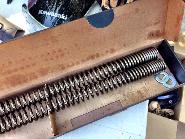

The KLR's first long ride made it painfully evident that the suspension would need some work. After researching tested alternatives I decided to go with Progressive springs on the front.
The installation is straight forward, just take care to not strip the aluminum threads on the caps. I'll spare the process details - you can find ample YouTube help, some good, some questionable.
Diving is minimized dramatically, sudden stops no longer induce more panic, return is solid. Great improvement.
