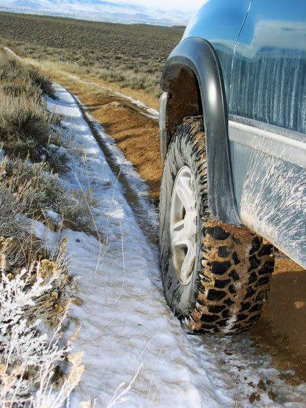

Not particularly... I'll be going back to the BFG AT KO's very soon.
I didn't find the TrXus to be any better in snow than the KO's. It took 10-12oz per tire, to get them to balance and the ride still isn't great. They pack up with wet snow/mud slime just as much as an AT.
Per the OP's inquiry, for long distance travel, they just aren't a great option. I can't say on a recent trip from WY, to UT, NV and CA and back across NV & UT again, that I was glad I had them. I was 300 miles into that 2,900 mile trip when I started planning my next trip to the tire store...
They're heavy as well, negating any weight reduction by going from a 285 AT, to a 255 MT. They may be tall 'n skinny, but they are heavy. My local tire shop had trouble finding valve stems to work with the stiff as a brick MT (but they could be morons), so I've experienced several slow leaks. The road noise I can ignore, the shoddy ride on asphalt, not so much. Their lack of significant off-road improvement (in places like the Alpine Loop, Canyonlands, Death Valley and the Red Desert) over an AT KO, combined with the weight and poor ride factor will have me returning to the BFG fold.
