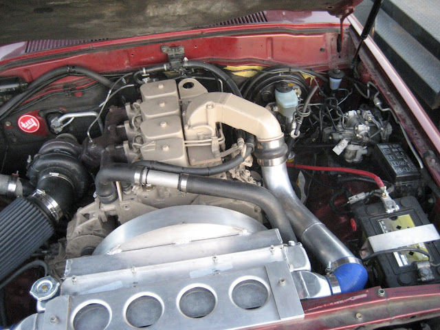

This is the 4BT80. That's a Cummins 4BT 80, using a 6BT intake/exhaust manifold cut-down, 6BT-turbo (H1C with 56MM inducer), NV4500, Orion, aftermarket intercooler. Oil pan chopped to allow minimal lift.

Did you have any issues with cutting down the oil pan on the 4BT-80??? As in were there any detrimental effects with the lowered capacity? Or did you keep the total volume the same and "chop" it around
the axle??? I've got a family Diesel Guru (Uncle who lives in Homer AK and buiilds/repairs Diesel motors and the ships/trucks they are in) who could build any of Cummins motors in his sleep im told so I'm really interested in moding one enough to fit it into a 60 without having it lifted 10" to clear the pan.

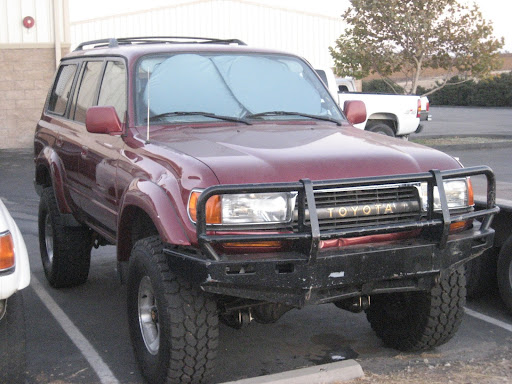

How have I missed this thread...Beautiful. Why didn't you put the ARB back on it?

I really like the new color!
I don't know if you saw my original question. Was the HDJ80 hard to register in CA? TIA.

I'm in the process of putting a 4BT in my scrambler (4BT-NV4500-Dana 300). Any advice on where to get a custom air to air (intercooler) made? The intercooler from the the donor vehicle, a 94 Oshkosh bread truck, is too wide so I am looking for one that will fit in front of the stock CJ radiator. In one of your photos it looks like your intercooler is a custom setup.
