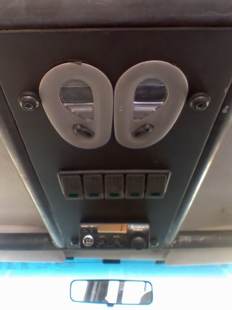

I made a center overhead console and mounted it up top. I have a K40 antenna mounted on my front bumper. The whole combo works great for me.

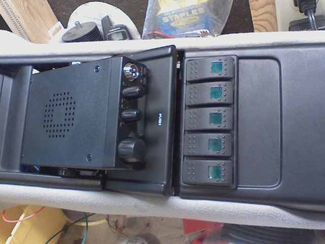

One half of a CB electrically speaking is the ground or whats called the ground plane. The center of the roof is the best ground plane if best CB performance is the goal. I use a spring and a cheap truck stop K-40 whip antenna so if and when I break it then I just screw a new one on. For me great communication is important because I run in large groups and we get spread out in the mountains so performance and inside location is also important. My rig is only used on days that I trail ride so the factory radio location was the ideal spot for me. I shed a few pounds by ditching the radio and associated wiring and speakers. Those rear roof speakers are heavy and located at the highest center of gravity anyway. I've been in 3 rollovers (long story).
I buy my CB radio equipment from Sparkys. He peaks and tweaks them for free and has all the mounts and antenna stuff you will need. I run a General lee. It has a super clean receiver and puts out 25 watts on low and 55 on high. Just enough for clean communications but not so hot it's noticed other than people say I sound great.http://www.sparkyscbshack.com/Saleitems.html
~James
That's really neat. Did you ever write that up? What was involved in making it?

Sorry guys, I dont have a write up on the console. It was just something I whipped up a while back. Basically made out of 1/4" birch on the sides, thinner stuff on the bottom side, and a scrap piece of carbon fiber in front of the CB just because I had it laying around. I used cardboard to make the roof line pattern. I mounted it to the old Dome light on the back side, and the lock remote thing between the sunvisors. It was pretty straight forward though. There is plenty of room for switches and all kinds of other crap, but I have places for those already.
I used (4) 20 watt 12 volt bulbs, two pointing towards the front, and two towards the rear.
