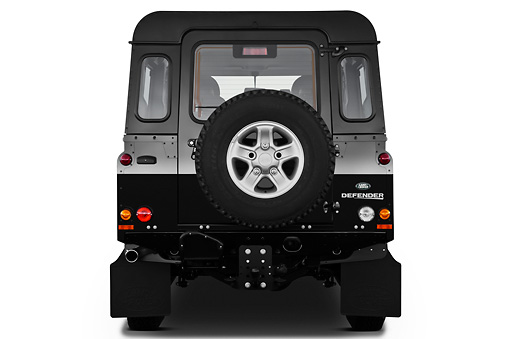

There's actually a design reason why it's not centered: to allow for easy clearance to the handle on the tailgate with up to a 40" tire.
I have the TeraFlex hinge and there's plenty of room with my stock Rubi tire on the back, and I know there's enough room with a 35" tire, but a 37" tire gets kind of cramped (still just enough room), but with a 40" tire, the handle would be severely encroached upon. AEV's off-centered design allows for plenty of room around the tailgate handle at all tire sizes.
It's funny to me that people are so caught up with the tires being centered on the back when classic rigs like the Land Rover Defender, and even previous Wranglers like the TJ and the YJ came with off-center spares on the back.
If you take a few seconds and re-read my post that you quoted, you will realize that I say exactly what you are saying about it being offset to clear the door handle in the first couple of sentences.
With this said, people make a fuss for a reason I believe. You are right that a few other models have offset rear spare tires, but if you are going to make it offset, make it offset enough so that it looks to have been done purposely, rather than look like you failed to center it.

Wow. My bad. Missed that whole first sentence. Long day at work staring at the computer, must have gone cross-eyed. :)
That said, given the design choice, I absolutely see why AEV has chosen *not* to release a "centering bracket" - If I were AEV, I wouldn't either. Wouldn't be hard for someone that was that bothered by it to rig up their own, or choose a different carrier altogether.
However, in my opinion, the AEV carrier looks more intentionally offset than the stock spare setups on YJs, TJs, and Land Rovers do; those look like someone used the wrong end of the tape measure. Just my opinion.

I see what you are saying... However, I had a TJ for 8 years and never realized that the spare was uncentered!!!! Wow..
On the other hand, I find that it was a bad business decision to build it like that, since I am certain that there is a lot more people that do not buy it because they are bothered buy the fact that it is not centered, than there are guys that will run 40 inch spare tires.
