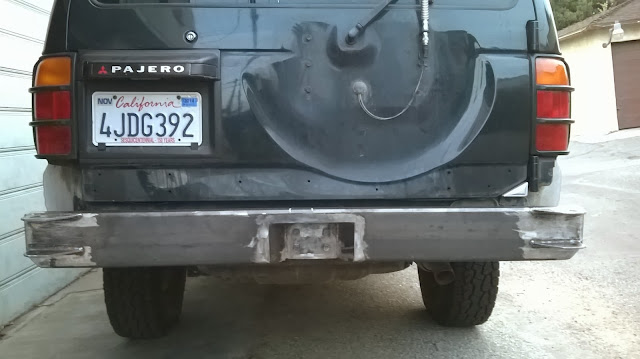

Dual Tire Carrier Swing-out Build, Part III
Had a little bit more time with the bumper this weekend. Last time around off-roader mentioned sleeving the frame ends. I thought that was prudent advice, so sleeve I did.
3/4 x .120 DOM with 1/2" ID
Fitted to the frame.
Welded and cleaned up.
Next was to cut down the hinges. When I had last stopped they looked like this.
I decided the extra metal was excessive.
Better.
Then it was time to narrow the bumper.
Capped the ends and finished them off.
Followed nwoods sage advice and beefed up the frame mounts with 1/4" gussets.
Test fit with what exists of the swing outs.
Improved mounts.
The bumper is actually narrower than the rear quarters.
And that was it for the weekend.
To be continued...
