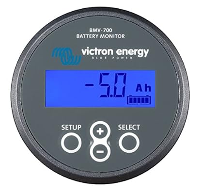

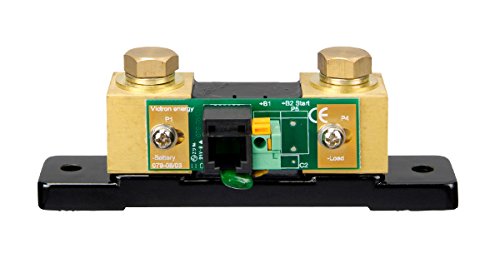

To get a proper state of charge, you need a meter (amp counter) with a shunt at the battery. All power that goes in/out of the battery gets measured. A meter like that is programmable - you tell it how many amp*hours capacity the battery bank has.
Bogart Trimetric and Xantrex LinkPro are popular and good quality. Since I have a Victron charge controller and MPPT controller/meter already, I've been thinking of adding the Victron BMV-700 battery monitor/amp counter, which has bluetooth built-in to use the Victron app.
https://www.amazon.com/gp/aw/d/B00M...ds=victron&dpPl=1&dpID=51mfuHsG-kL&ref=plSrch
Meter:
Shunt (required for amp counter meters)
