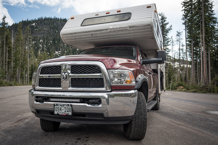

I'll be honest, the headlights on the RAM aren't the best. As in, 2.5/10 kind of performance, most of that owing to the fact that they do indeed throw light. I'm not sure if the projector versions are any better, as they come from the factory, the headlights leave a lot to be desired.
During ordinary driving in developed areas with street lights, this isn't a huge factor. It is however, a huge safety liability on backroads and in remote areas with no ambient light to supplement the head lights. Honestly, I'm not sure I'd feel entirely comfortable heading out without knowing I had some additional light source in my pocket for those times when it's needed. I've used it countless times cruising back roads and fire roads and always marveled at how much I love having it.
On my Tacoma, I had a couple of cheap, LED light bars that I found to remedy this situation, and I can credit them with helping avoid several collisions with deer. I wanted to do the same on this truck, albeit in a less intrusive fashion.
In steps the Rough Country LED light bar brackets. These mount behind the front tow hooks and offer the ability of mounting a 22” light bar with no fabrication necessary. Sounds good to me! I paired these with a Rigidhorse single-row LED light bar that I bought off of Amazon, and a light bar wiring harness kit and was off and running.
At the forefront, I'll state that the Rough Country brackets are mediocre. They are one of those “kinda” pieces of hardware, the bolt holes kinda line up and the brackets are kinda bent to 90*. This is a shame as they need very little work to become an awesome solution, but I was able to make them work none the less.
The first step is to remove the tow hooks. I recommend an extra set of hands with this part of it as the bolts don't have captured nuts, so someone has to be on the back side with a wrench. With these out of the way, you can start mocking up the light bar and brackets to begin massaging everything into place. It took a few rounds with a crescent wrench and vise adjusting the brackets, and someone pushing on the bracket to get the bolt holes lined up, before it could all be installed. Tow hook bolts were re-installed to the “tight” spec.
With the bar in place, you can begin running the wiring harness and switch. Space in the engine bay is at a premium, so it took a bit of playing before we finally found a location for the relay that was close enough to the battery and did not require drilling any holes.
Unfortunately, this location did require extending the power leads from the relay to the battery, but that was more to satisfy my own desire for neat wiring than anything. The positive lead does come with a fuse holder for safety.
Running power to the light bar is a matter of personal preference, but I loomed the wire to provide protection against chaffing. All splices were soldered and covered with marine heat shrink for extra protection.
The next challenge was finding a good place to run the switch wires into the cabin. Previously, I've poked a hole in the main firewall grommet, but I never liked that method as it was never as neat or weatherproof as I hoped. Luckily my friend Dan, who I have to give copious kudos to for helping with damn near all of these mods, pointed out the blank cover plate that on a manual truck would be used to mount the clutch cylinder. It was easily accessible from both sides and provided a sturdy place to drill through and run the wires. At a later date, when I have an opportunity to run more accessories, I'll mount a bulkhead fitting on this plate to provide a plug so nothing has to be run through the firewall.
I chose to go with a push button switch. While flipping a Carling rocker switch is satisfying, it also required either cutting a hole in the dash or purchasing a switch pod, neither of which I was interested in doing. The switch was located just under the steering wheel where it is convenient to turn on and off.
I did have to replace the double sided tape on the back of the button, it kept coming off in hot weather. I used a bit of 3M moulding tape which has so far provided a very solid attachment.
As with any light source, it needed a bit of aiming after the fact to be useful. Due to the bending and manipulating necessary to get the Smittybilt brackets to work, it's not perfect, but it's good enough as it. The bar throws a okay amount of light, certainly not what a higher quality LED would, but you get what you pay for. The spot lights in the middle extend the field of view significantly, and the flood lights on the sides help to illuminate the side of the road. Durability with the bar has proven to be an issue as there is already condensation behind the lens, but it still works going on 1 year later. It will eventually be replaced with a higher quality bar, more than likely something from Baja Designs.

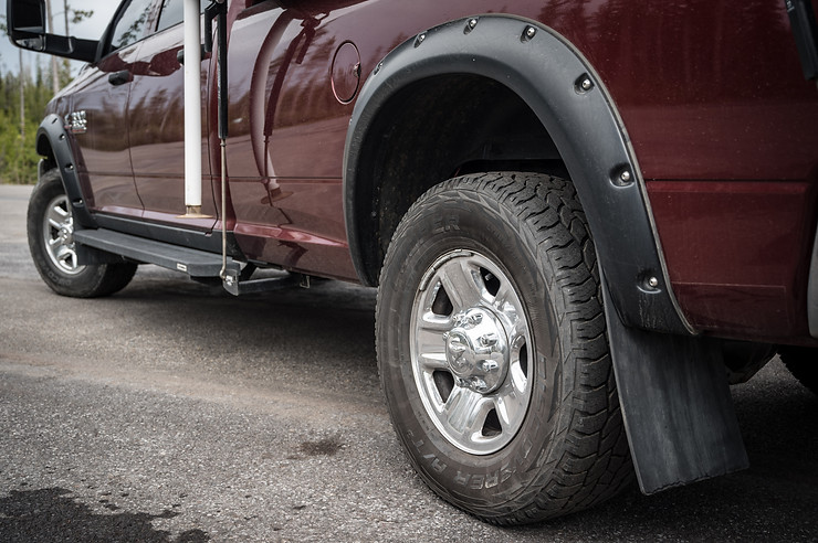

We all know them, Bushwacker pocket fender flares. They appear on everything from hardcore offroad rigs, to show queens, to absurd trucks with 48" of lift and low profile mud tires on high offset chrome rims. They are, in the RAM world, a cheaper and simpler option for those of us looking for additional crud catching capability without cost or cutting required for the AEV Highmarks. As I doubt I will ever run tires larger than 35", I didn't need the additional clearance of the Highmarks, but I do intend to add aftermarket rims at some point to push the tires out a bit and needed the additional coverage both to capture mud and to ensure I am road legal.
I was perusing the Amazon warehouse deals one day and caught a set of NIB pocket flares for 50% off the regular price. I snatched them up and a few days later laid the pieces out and begin installing them. After installing the billion bolts, washers, and nuts that come on them, I turned to the most daunting part of the process, installing the edge trim. This part sucks. Flat out sucks. The stuff doesn't want to go on, and it was by far the most difficult part of the installation. Two hours and two sore forearms later and I had it all attached and ready to install.
Installation requires little more than a ratchet and socket to remove the OEM fender liner bolts, place the flares on the truck, then re-install said bolts. Be sure to clean where the edge trim will hit the fender, and preferably apply some 3M clear tape to prevent scratches down the road. Things were a bit tricker in my situation as I have Duraflap mud flaps and there were some mismatches in the bolt patterns between the two, but nothing a drill and drill bit couldn't fix. After opening up a few holes in the Bushwackers, I wiggled everything in place and bolted them down. Tada!
As expected, they have cut down on the amount of crap getting flung on/at the truck significantly. While the mud flaps did an admirable job by themselves, bigger tires and less offset rims require a bit more coverage. This will be a huge plus when we relocate to Massachusetts, which is notorious for failing vehicles for tire poke, following this trip. The only unfortunate thing I experienced was the flare contacting the Cummins badge on the fender. YMMV, but my badge will either need to be moved or removed entirely. I haven't addressed this yet, but will at some point.
Another problem I had encountered but had yet to figure out a solution for was scratches in the paint on the sill from our dogs jumping in and out. They were quickly destroying that area and the thought of repainting it so soon wasn't exactly palatable, so once again I turned to Bushwacker and Amazon Warehouse deals to grab some NIB Bushwacker sill guards. These handy dandy plastic pieces wrap around the rocker panel on the truck and extend up onto the sill to provide protection both outside and inside. They attach using non-continuous moulding tape (moisture can escape!) and other than having to remove my running boards to install went on easily. I simply cleaned all areas the tape would touch with rubbing alcohol, peeled the backing strip part way back per the instructions, stuck them in place, then pulled the rest of the strips off and pressed them on all the way.
Fit, finish, and durability is excellent. It has held up very well to the puppets, which is more than I can say for the weather stripping in that area. RIP weatherstripping.

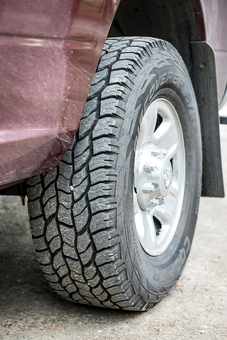

One of the most important choices to make when outfitting the truck for our adventure was tires. Practically speaking, they are the only link between your vehicle and the pavement, so choosing an appropriate tire for the expected conditions is paramount to safety and reliability.
In our case, we needed a tire that would perform in all weather conditions, had adequate payload capacity for the truck + camper, had minimal road noise (after all, we are going to be pounding out a ton of highway miles), and was the biggest I could fit on the truck without clearancing.
After much research and debate, I narrowed it down to the following:
Cooper Discoverer AT/3
Nitto Ridge Grappler
Toyo Open Country AT2
Cooper ST Maxx
General consensus was this lineup represented the best performing all terrain tires for full-size pickup trucks. Of the four, I ended up choosing the Cooper Discoverer AT/3. While they are probably the least aggressive of the bunch, they are purported to provide more than adequate traction in inclement weather. Additionally, they are also supported by a 55K mile warranty and were sourced for the right price with replacement certificates through Discount Tire.
The OEM size Firestones were 275/70R18, which works out to ~33.3 inches. My research indicated that a 34.5” tire was about the biggest that would fit without swapping to wheels with less backspacing or clearancing (http://www.thurenfabrication.com/tech/tire-and-wheel-fitment.html). The Cooper Discoverer AT/3 in 295/70R18 fit the bill, they are just shy of 34.5” and are E-rated with a single tire capacity of 4,080 lbs at 80 psi.
After getting the tires mounted and balanced, I cycled the suspension (while installing the lift kit) to ensure that they would not rub anywhere throughout the travel. While they didn't rub during cycling, it turns out that they would kiss the radius arm and sway bar during full lock maneuvers. This may related to the track bar not being the correct length for the lift on the truck at the moment, but I would wager that they would contact even still when packed up with mud.
The tires now have about 27,000 miles on them, which includes a healthy mix of pavement and dirt. On pavement they are solid performers, the inconsistent tracking experienced with the Firestones was eliminated while road noise is barely if at all audible in the cabin. They are at 10/32" tread wear, which if I take them down to 4/32" would calculate out to about 55K miles as promised. Either way, they have delivered with no tread chunking or cuts, and only a single flat tire from a bolt I picked up in the road. That was patched 24K miles ago and has held ever since.
They did wear a little bit funky going into the first tire rotation, which I can attribute to the frost heaves and crosswinds of the Yukon territories and eastern Alaska. This resulted in accelerated wear on the outside edges of the tires despite the alignment and tire pressure being okay. It was by no means severe, but it was evident. They have worn fine following that first rotation, and have worn even better since being re-balanced at 20K miles. Their performance has been confidence inspiring and stellar, with only two instances of us requiring a little bit of extra maneuvering, once on a sheet of ice, and once in a wet, grassy ditch. Otherwise, across all of the highways, secondary, and tertiary roads, the fire roads, gravel, rocks, snow, rain, and mud, they have worked fabulously and have never left us stranded.
While they may not be the coolest looking tires out there, their superb all around performance has me resolving to get another set when these wear out. They are absolutely terrific and I can't sing their praises enough. For those in the market for something less aggressive than a mud terrain, but still need something that will hold up to the abuses of towing/hauling on an HD pickup, give these a gander.
