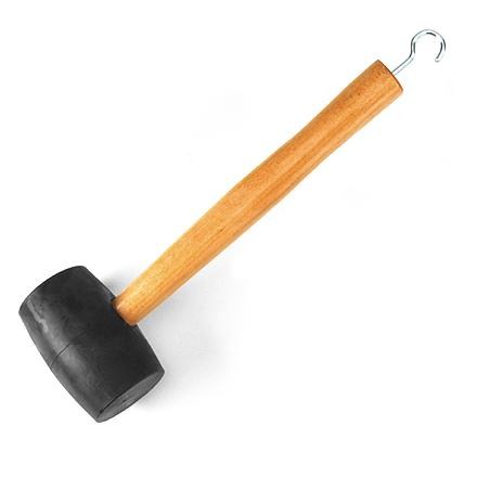

Kind of makes my old Coghlan's mallet from Kmart look homely but it still works!
