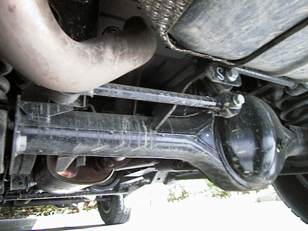

Panhard bar is up front. Still there on the D2.
Watts Linkage/A-frame is what Rover used on the D2/D1 respectively to keep the rear axle centered under the truck.

Panhard bar is in the front and keeps the axle centered under the front of the truck. Here's a pic of one on a D2. Its the bar that is closest to the axle housing that has the kink in it at the far end:

(Hang on, I'm confused on that photo. It's got ball swivels, so D1, where's the A-frame? Oh, is it tucked up higher above the drive shaft, must be, wouldn't fit below.)
I have a 96 and recall when the A frame was clunking in it's mount. Not sure what mileage that was though, maybe 200ish. So the A design for the rear is what helps a D1 give more articulation off road right? But obviously less tight handling on-road. This is part of why a D2 feels like a sports car compared to the D1 ;) Well, even more so when the D1 had Billstein but with 100,000 miles on them and the D2 had new OME 2" kit springs and dampers.
