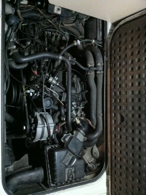

I have a led light strip over the kitchen in my Westfalia. I’m quite happy with it. I would have to look back at the model numbers to get the specifics. But mine is the warm white waterproof strip with the self adhesive on the back. I have it hooked to a capacitance touch dimmer. I also have a nice swivel led light fixture over my engine bay that can be powered by 8-AA batteries or off my lighting circuit in the camper. I use the size M (5.5mm) coaxial power connectors for my lights so I can just pull this off vehicle power and attach it to a battery pack if by chance my work in the engine bay is related to a dead battery. The engine bay light is the more atypical cold white of LED lights. The pictures show only a little difference but in real life the warm white is much more natural looking. I cleaned the mounting surface with alcohol before sticking the led light strip over the kitchen and I have not had any problems with it coming loose. 3M molding tape is wonderful stuff if you do not want to buy the light strips that have adhesive already on them. I got all mine and the dimmer from superbrightleds.com . There were some cheaper options directly from China but not so much cheaper that I wanted to wait for the extra shipping time. I spent about $75 on everything. Just the strip I could have done for under fifty shipped. But I don't even hesitate to turn on the lights when we are camping.

With the engine lid off.

westicoast i know all new vehicles are like this but i have to ask, is there an engine under all that junk? boy i am glad i do not have to work on that. highdesertranger
Allow me one or two LOL's for this one:xxrotflma. My vehicle is 29 years old. Its not quite as complicated as it looks. Its a boxer engine so everything but the exhast ports and the oil filter are on the top side. It's very easy to work on.
