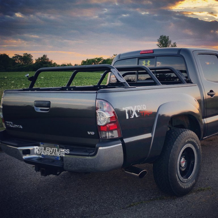

An inexpensive, strong bed rack can be made with a pair of bed bars with side tabs, and some Unistrut bolted between the bed bars. The rack will be plenty strong to support whatever you want to mount to it, including an RTT. The same goes for the Unistrut.
I used to carry my RTT on two Relentless bars.
The gold bar between the bed bars is Unistrut.
If you chose to mount much weight that rests on the bedsides, I recommend replacing the plastic OEM bed caps with metal ones. The plastic parts will chew up the top of the bedsides, leading to rust. If enough weight is focused in an area, they may begin to collapse. KB Voodoo and Relentless make them; there may be other sources. If you have the ability, you could make your own.
