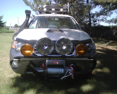

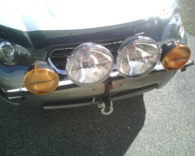

It may not be the prettiest you've ever seen, but form needs to follow funtion in this case! And it's surprisingly stable on the road (lightbar that is) considering the uniqueness of the mounting. If necessity is the mother of invention, then I must be invention's crazy-ass half/brother! :exclaim:
2" FRH mounted below front bumper with 6"x3/4" Grade 8 bolts. Welded cross members to follow before the winch is put to use!

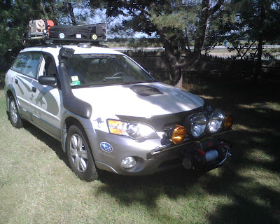

Fully loaded. There is barely a drop in the attitude of the nose thanks to the lift springs from King Springs!

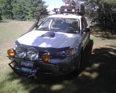

Here she is with the winch safely stowed.

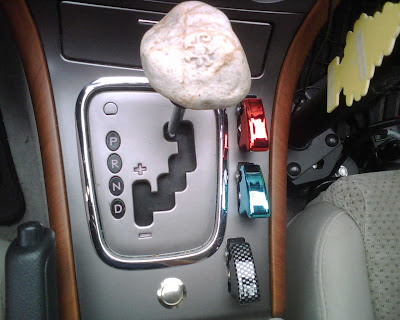

On a side note, I love my new shift knob! Arizona river rock with a gecko to boot!

Hitch mounting is very clean, and it is awesome that the winch is removable! You can place in the front or back, whichever is needed!
