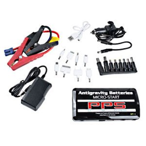

The Antigravity XP-1 really looks like an awesome little pack. Small enough to stow under the back seat, or in a glove box. Reports say it will stay charged for up to a year.
I picked up one of the Antigravity Batteries MICRO-START/PPS XP-1 onAmazon for $144 shipped.
I will say that the video did help sell it:
I had seen this thread and another on the lithium battery booster packs, but lost track of them. The whole idea stuck with me and when a little mad money showed up, I bit the bullet. I had been wanting to experiment with a pack like this and see if the solar panels work well in conjunction. At the very least this will be much more convenient to carry as a back up plan. It also gives be the ability to carry it along on the motorcycles too. I like that idea :)
The "kit" really looks great. It will adapt to virtually anything. The size is fantastic. It fits right into the pocket on the solar panel bag :) I will play with it a while and see how it pans out for me. Thus far (rose color glasses on) I like it!

Tried starting a friend Mustang today. Cranked it over a few times, and then quit. No start. :( Showed one light after that try. I will charge it back up and do more testing. Cloudy day, so no solar charge testing today.
