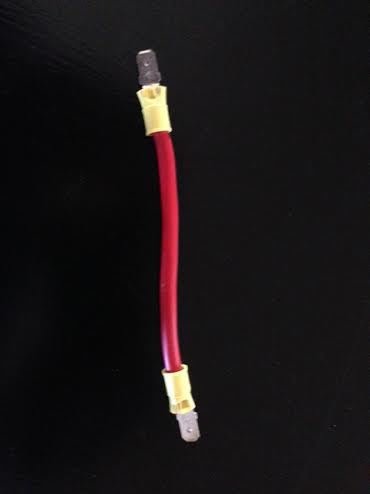

This is a jumper I made that goes in the under-hood fuse box on my Tacoma. It makes the power outlets in the cab "hot" even when the ignition is off. That lets me charge phones or tablets or whatever while camping without needing to start the engine.
My brother made it out of some stuff he had lying around, so it cost nothing!
