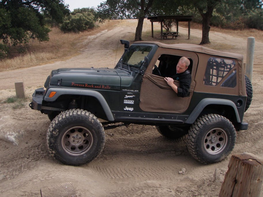

I've been running one of the earlier 'do it yourself' versions for quite a while on my TJ (AW-4 tranny and NP231, no sump on mine). Works great and no need for a BL.
Jason
pic of nice clean belly lines :
