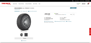

looks like a tire "fix" but... the pricing is abusive.
zimm
I think for the size of the truck, approach, departure and rollover would benefit from a couple inches. These and the typical 1" spacer for a Gwagon would ad some versatility, not really affect the drive, and as a bonus maybe help the "little tire" look of the 31.5's.
I wonder what manufacturer requested these oddballs, that they should be making them. The price is sorta bespoke.

Wow - the price has gone crazy on those since the last time I priced them (like maybe $100+/tire). I don't think any manufacturer ever requested them. I looked into them a few years ago and decided to not go with them because they're load range D (I wanted C) and in true BFG fashion, they aren't anywhere close to the 34" dia as advertised.

It's minus .5 for almost all BFG's for some reason. They are still about 2" taller than stock Grenadier tires. What I noticed was the cross section. I really haven't seen much about where the interference lies with larger tires in this rig, but getting into a "34" class tire without dealing with a 12.5" cross section is a bonus I would have to believe. This tire seems to be Alone in this oddball near tall/skinny configuration.
As I recall, I had several friends with them measure them (might also be noted here on ExPo somewhere) and they weren't even 33" in loaded height, which was very disappointing to me.
I'm a tall/skinny tire fan myself - I had a 35/10.50/17 Kenda Klever tire a few years ago to try for fitment. People seem to really like those and I think I only paid ~$160'ish? for the one I had for awhile. I'm sure they've gone up a lot since then.

I've been really happy with my current Duratracs, I'd be interested in the new Duratrac RT as well. That pricing on the KO2 is insane.
