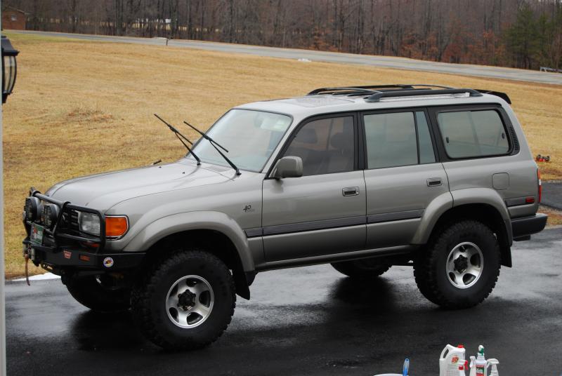

Can you send me some info on the rims? I'm running an 80 series and am about to do the hub outer only swap based on your write up because I cannot find the chevy/dodge stock 8 lug rims anywhere at a reasonable price. Concerned about the backspacing as I definitely want the wheels/tires flush underneath the wheel wells.
I'm running factory Toyota 40th ANV LC rims, but may opt for some aftermarket wheels for the trailer.
Any help would be appreciated!
Cheers,
Mike
pic of my wheel style https://forum.ih8mud.com/attachments/044-jpg.491968/
