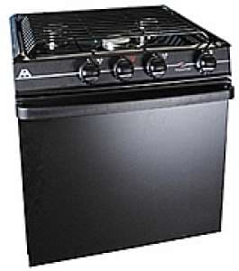

Just a curiosity to me. ....image...
That spot often becomes the cook top/oven combo
