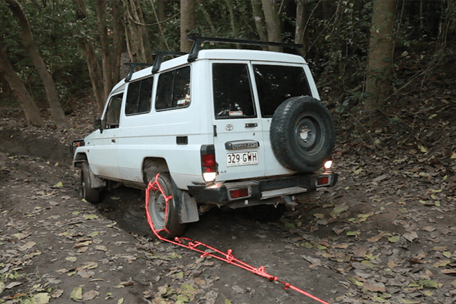

By the way (or: In addition), I carry this funny wheel whinch system from Australia. Not this big steel add on wheels called bush whinch, but the BOG OUT recovery kit. It is just a bag of ropes, it weighs almost nothing, but can get us out in both directions.
Of course, if there is a winch point. (in the sand you could burry your spare wheel or buy this dead man anchor point bag)
Another compromise haha. A normal winch would be easier to use, but I didn't feel like adding 50kg and then still only be able to be helpful in forward direction.
Haven't needed it yet, so cannot comment on how good it works. This is not my photo:
So the above + one set of waffle board + a shovel = a nice kit that should get me out of most places and is still pretty lightweight.
Hi there - thanks for introducing BOG OUT - we are the inventors and manufacturers. We always love hearing back from our customers. This is not just a new product, but a new technique to get you out of a bog. It will work in forwards or reverse. As you can see in your pic here - a single worked for a light bog, though two or the Twin provides a power diff locked wheel winch. Here's a fun video where we got ourselves bogged in thick (very stinky) mud and needed to use two because all wheels were spinning. We'd love to hear back from anyone who has any questions.
