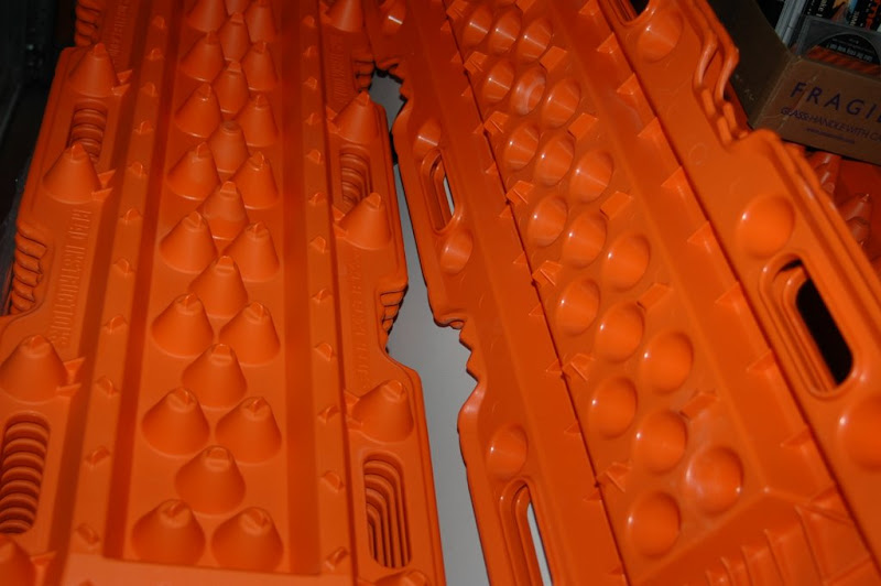

And what does the bottom shape/grips looks like ? :)
The bottom looks very similar to the top. I"ll see if I can run out and get a picture for you tomorrow. I'll post it up as soon as I take the picture.
Here is a picture of the back portion of the MAXTRAX:
Sorry for the bad lighting. The set on the right is showing the bottom, where the set on the left is showing the top. In testing the bottom provided enough grip in snow, ice, mud, sand, rocks, and sand.
