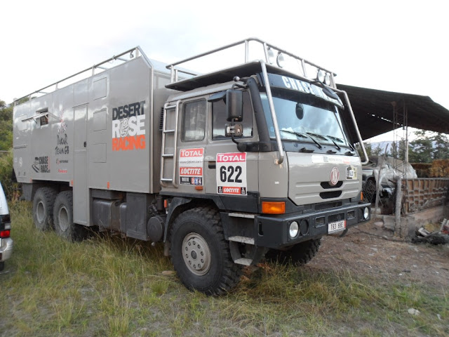

I was struck by the strong contrast between your childhood visions of a fully integrated, 6x6 motorhome, versus the vehicle on which you are now working, which is a much more conventional sort of “cab-separate-from-camper”, non-integrated design. And yet even relatively recently – around 2008 or 2009? – it seems that you also produced an elevation for an expedition motorhome that was also fully integrated. Whereas the vehicle on which you are now working is not integrated.
When did you decide to go in this direction instead, and why? After you saw Edy's Robusto? Or once you began the build?
For a fuller explanation of the question, please see the thread, “Fully Integrated MAN or TATRA 6x6 or 8x8 Expedition RV with Rigid, Torsion-Free Frame”, at http://www.expeditionportal.com/for...pedition-RV-w-Rigid-Torsion-Free-Frame/page22 .

pairospam
Sorry for the delay in the updates.
@ LoRoad: the distance from the front axle to the second is 3,25 meters, and in between the tandem axles is 1,35 m.
@ biotect: what a huge amount of research, effort and words have you put on your thread! The answer is very simple: I follow my visions but I use what I have at hand.
I didn’t even start to build a fully integrated 6x6 because the buses that were the basis for the build doubled the price in quiet a few months, and the technical challenges for adapting a 6x6 drive train and suspension on a frame built for gently carrying people from one to another point of the city were too big that the idea sunk by its own weight. An already working 6x6 truck was the natural option, even if it took me 6 months to find mine.
From my poor and humble point of view, that has a little of experience on the matter, integrate driving and living cabins is, apart from being difficult from the technical and aesthetic point of view, not appropriate if the truck has been conceived as a vehicle without such an arrangement. You put a lot of stress on the frame/suspension doing that and things become damaged sooner or later.
This, obviously do not apply to the 6x6 and 8x8 Tatras with independent suspensions or to any truck with rigid-conceived main frames.
Let me say also that a cab-over-engine truck is more fun and easy to drive in all-terrain conditions than a cab-behind-engine from my point of view (but it is always fun), allows for a longer living cabin, and the added roughness and soundness can be managed with air seats and appropriate noise insulation. But, hey! concepts are quiet different and anyone has its own preference and this is precisely what these threads are all about.
Whatever your particular idea of the most appropriate vehicle for going around the corner or travel the world with will always be okay.
