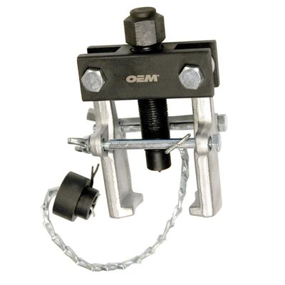

For those who are thinking about one of these conversions but are on the fence because you might not have the right tools... Autozone (and other auto parts stores) have good "loan-a-tool" programs that can help you get by. During the most recent conversion I was working on, my pitman arm puller gave up on life and I was forced to find a different solution. Harbor Freight tool didn't last a second against my impact wrench and then I remembered Autozone...
I went and got this...
4
http://www.autozone.com/loan-a-tool...y-pitman-arm-puller/209523_0_0/?checkfit=true
and in a few seconds the pitman arm was off. No cost to me, other than driving back and forth to the store.
It's easy to forget some of the resources available around a lot of cities/towns for those who don't have big shops with lots of tools.
4
The loan a tool programs are helpful, especially for some of the rarely used tools. The last time I borrowed a tool was a fan clutch water pump tool.

^^Agreed! I persued the same route when removing my pitman arm and most recently when changing the clutch and coil on the a/c compressor of my wife's car.
