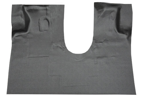

Looking good. So what is the order of the stack of materials in the front from metal to vinyl? I’m looking to rip out the old carpet in the cab of my chinook. It’s got a 1” lip from cab to back plywood. What do you think he max amount is that you can raise up the front area and still have the stepwell trim fit?
Chinooks are nice! Stack of materials are, bare metal, 3 coats POR15 black, butyl backed (dynamat or noico), 1/6th inch closed cell foam, then just added 1/3 inch closed cell foam, jute padding over the middle and foot areas, then vinyl. It really makes a huge difference with the noise level and overall comfort in the cabin. I would say its about 1/2” now of overall closed cell foam. When you tighten back the seat belt and seat bolts it puts the squeeze on the foam. And creates more of a dip in the immediate area since that 1/2” is being squeezed down. For the step wells it only matters if you take the insulation all the way to the lip the step well sits on. Closed cell foam will compress. If i had to do it over, I would trim back the thicker foam from the step well edge and just have the 1/6” foam or something thinner than the 1/3”. 1/3” is pushing it. Hope this helps! ?
Most of all. Take your time. When you get new carpet or vinyl. Take your time installing it. I almost messed up and had to order a new one at $160. The cuts are permanent. I spent a couple days installing it.

Ah, tapering the materials at the edges makes sense. Did you cut out where the seats bolt, or does that get compressed with the foam? Not sure how mine is setup. The 20 year old green RV carpet needs to go. Not that bad, but not that great... Do you have a good source for your vinyl? I want something that’s more utility than carpet, but not as utility as the vinyl that was in my last ambo.

Hey bud. It was not necessary to cut the foam. Just a small hole with a screwdriver. It gets squished when everything gets tight. I saw one ambo build thread use the grey black outdoor carpet from Home Depot. I got my vinyl from Stock Interiors. I think with shipping it was about 150$? Id have to check might have been 160$. I like the vinyl because you can clean it!! Everything that came out I couldnt imagine it embedded in fibers. I am thinking of cutting some light carpet, perhaps the grey stuff from home depot or lowes, for the areas where your feet go and in between the seats and around to cover the back of the seat on the floor. And its just sitting there. So it can be taken out to be cleaned.

The front area of the econoline is pretty simple, but I'd still want something slightly molded. Vinyl with then a removable carpet isn't a bad idea. Those are for sale for $95 on amazon.

Cool. Nice idea. Ill check em out
