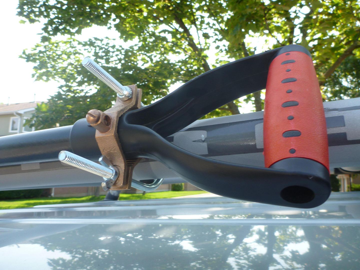

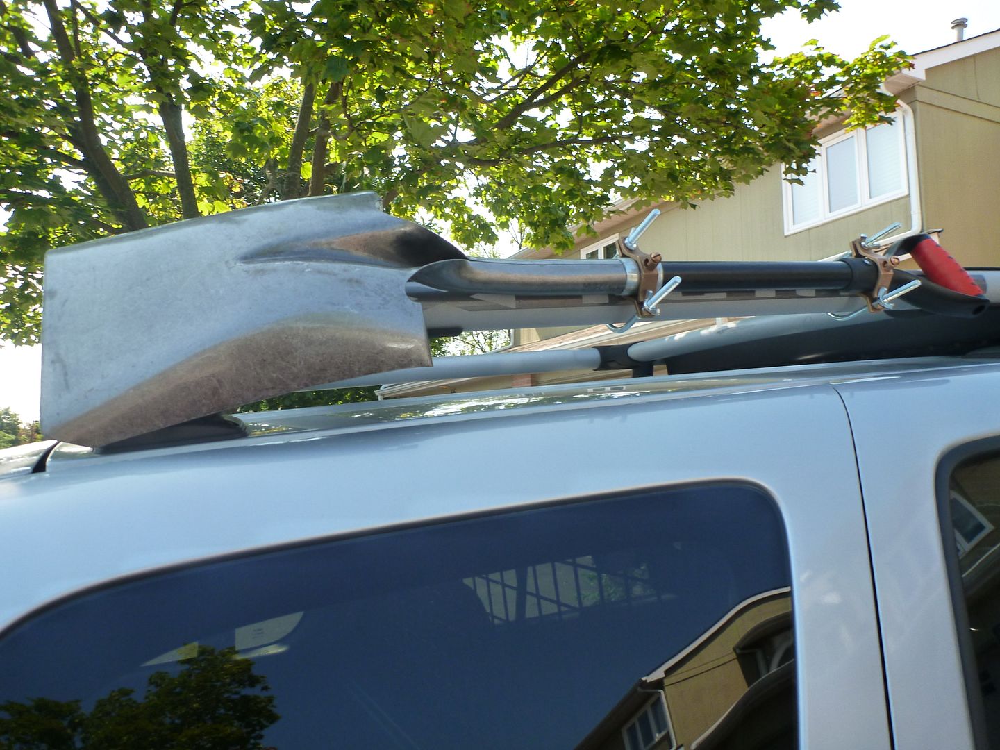

I have been looking for a couple months on a cheap and easy way to attach a shovel to the factory Xterra rack, after a few iterations here is what I came up with.
Each end of the shovel is held onto the rack by a 2.5 inch x 4.5 inch U-bolt. At home depot I found a grounding clamp to grab onto the shovel. It actually ended up working perfectly. The holes in the grounding clamp are the exact same spacing as the u bolt. One side of the clamp has threaded holes, which will have to be drilled out so they can slide over the u bolt. The other side already comes large enough, with one of the holes open on the side so it can swing out without have to take the wing-nut off. This is actually an advantage because the shovel can come out without have to undo the whole thing.
Depending on the shovel the clamps might be just a little big, but the shovel had two larger spots on it were they clamped perfectly. You can easily rock the truck with one hand on the shovel. I will see after this trip how it works out and modify if necessary, its not something that I will need often so as long as it is secure up there I don't mind if it takes a little effort to get it on and off.

Crafty! I like it a lot. I don't think you'll need to use it much so the effort required is actually a deterrent to someone who might be looking for a free shovel :)

thanks, I cranked down the wing nuts with a crescent wrench so they shouldnt be going anywhere, the grounding clamps were actually about $10 each, so they are worth more than the shovel haha!

As an added measure you might want to consider using split washers to help hold the tension on the wing nuts. As for security you could always drill a hole in the u-bolt threads past one of the wing nuts and attach a small padlock to it.

both great ideas, I might run out and grab some split washers in the morning before we leave, I could see them coming loose after awhile. The lock is a great idea as well.
There is also a bolt in the middle (you can see it in the pictures) might be a good spot to put something else up there (something light) but haven't thought of anything yet. Perhaps an axe with holes drilled though the haft with longer bolts and some washers, would go up there nicely.

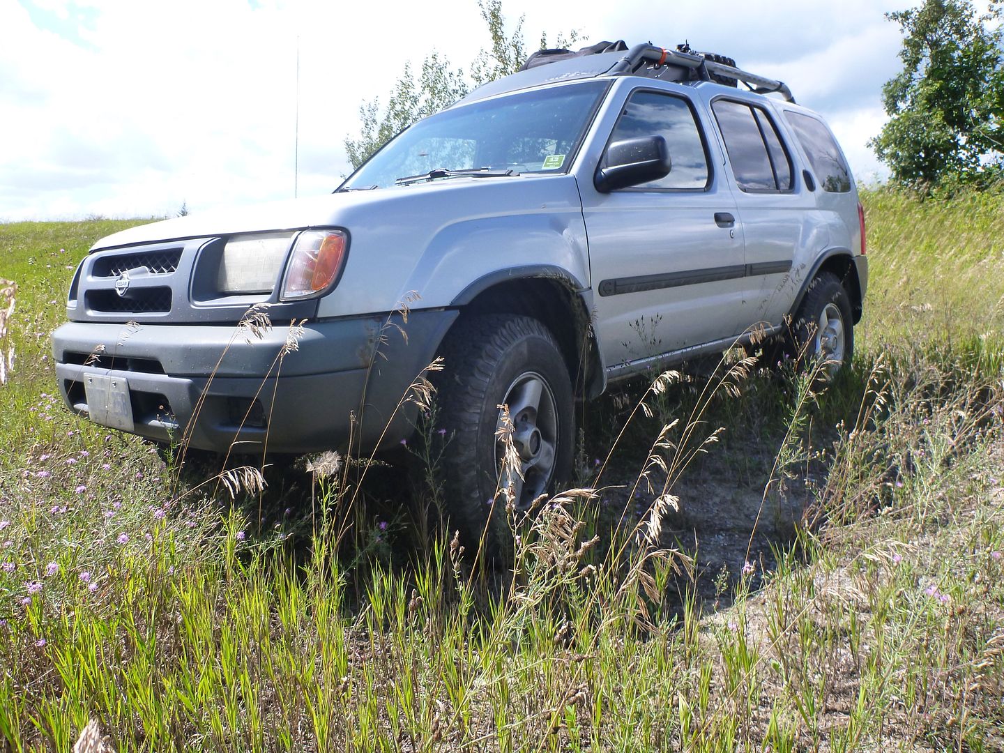

Looks good! I love driving in fields, but I have a question, what exactly is the piece of what appears to be plastic on the roof rack in this picture?

hahaha you got me
the front floor liner was wet and dirt, so I had it up there this morning to dry out, forgot it was up there so it was on the back for the last 30 minutes of messing around. We got to the front gate of the property and almost left when I realized it was missing, wasnt on the back, we had to go back and check everywhere we drove. Turns out it just fell after that picture at the top of that hill. It would have sucked if I didnt realize until home 3 hours later
I love field driving as well, it was pretty light grass so I wasn't worried about the paint scratching
