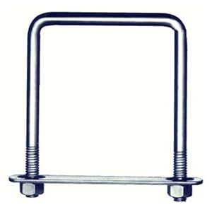

I received my TREDs last week from Sierra Expeditions. I have a square Garvin Wilderness rack on my FJC. Decided to use square U bolts with wing nuts to hold them.
The fronts are 2" wide and 4.5" high with 3/8 bolts. The rears are 3.5" wide and 6.5" high with 5/16 bolts. The local Ace hardware did not have a matching set of 3/8 vs 5/16 in these sizes.
I then used Plasti Dip and sprayed from the bottom half to the bottom of the threads and the top plate where the wing nuts thread down on.
I dont have any real world experience with them yet. But they are locked down and I can run my cable lock through them as well as my high lift so not worried about someone stealing them. The TREDs mounting kit does look cool.
