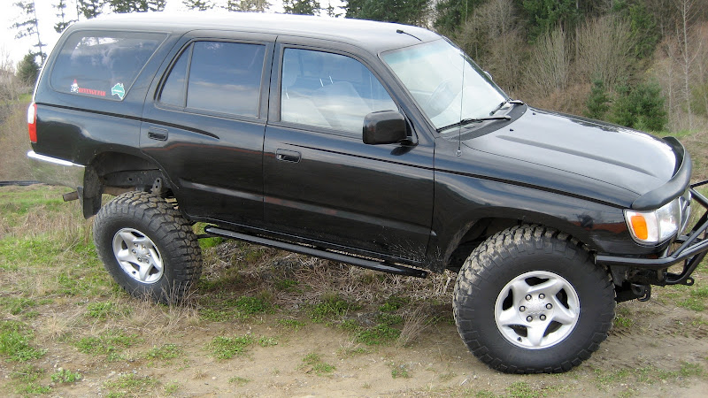

Right now sitting in my garage they measure exactly 37x12.50. I think they may have changed things for these radials. I also like the lack of a balloonish tire with these new radials.
Here is a pic of them in my garage just to show off the great treat pattern:
