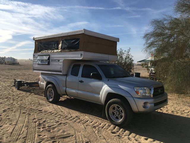

Been a while since my last post, or trip for that matter. But dune season is upon us, so I prepped and loaded the bikes and camper up this past weekend, and headed out to Cali to tear it up. The camper did great as usual, although this is the first time driving at night with the setup, so the lights were useless with the bit of sag from the setup. No worries tho, gonna try a few different things to help the rear end sit level and off the bump stops over bigger bumps, gonna start cheap with some spring helpers and re-asses.
Things may be changing down the road however for this setup. While Its a great setup and works really well, loading the thing is a major pain in the ass. Maybe if I could store it on saw horses where I would only need to life it a few inches to get it on and off the truck would change things, but having an HOA, I have to store it in the garage, which requires getting it from the ground up to truck height and vice versa, a very sketchy and stressful event. Im planning on moving back into town next summer, and I hope to find a house with an RV gate or at lest no HOA so I can store this elsewhere. But I've been reading up on enclosed trailer built out as DIY toy haulers, so that may be the next step. So if anyone is interested, I may be parting with the ol' Skamper here soon for a good price, especially for someone on here. We'll see, for the time being tho, this works great.
Until next time, Happy thanksgiving!

Well, according to an old sales brochure I found on it, the dry weight of a 072S is 955lbs and the wet weight/loaded weight is 1090. With it not coming with its original sink, cooker, furnace, and fridge and what not, I'm sure the weight has been saved there, however with the re-enforcements Ive made to the roof/floor and other areas its added some, so I'd like to say its prob right in the same ball park as the OEM specs.
My Tacoma has no issues lugging it around, and I haul this setup up some big hills, some of which I lose my friends on with their full size trucks pulling similar setups. That may just be my technique however, I learned in the old hardbody days lugging up those hills its all about momentum/inertia/run up :D
