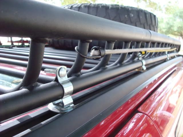

I think I have the same roof basket (Rola Vortex with extension?) and mounted mine directly to the roof rail. I used 8x conduit clamps. It's extremely secure, lower profile, and looks better IMO.

Yep, it's the Rola Vortex with extension. I have mine on the Thule loadbars with custom feet and it looks very proportional to the truck. It looked hideous on the factory cross bars.
Ya, I took a second look at your setup after I already posted, and realized you have it on aftermarket bars. Yours looks pretty good; yes it looked hideous on the factory bars. lol
