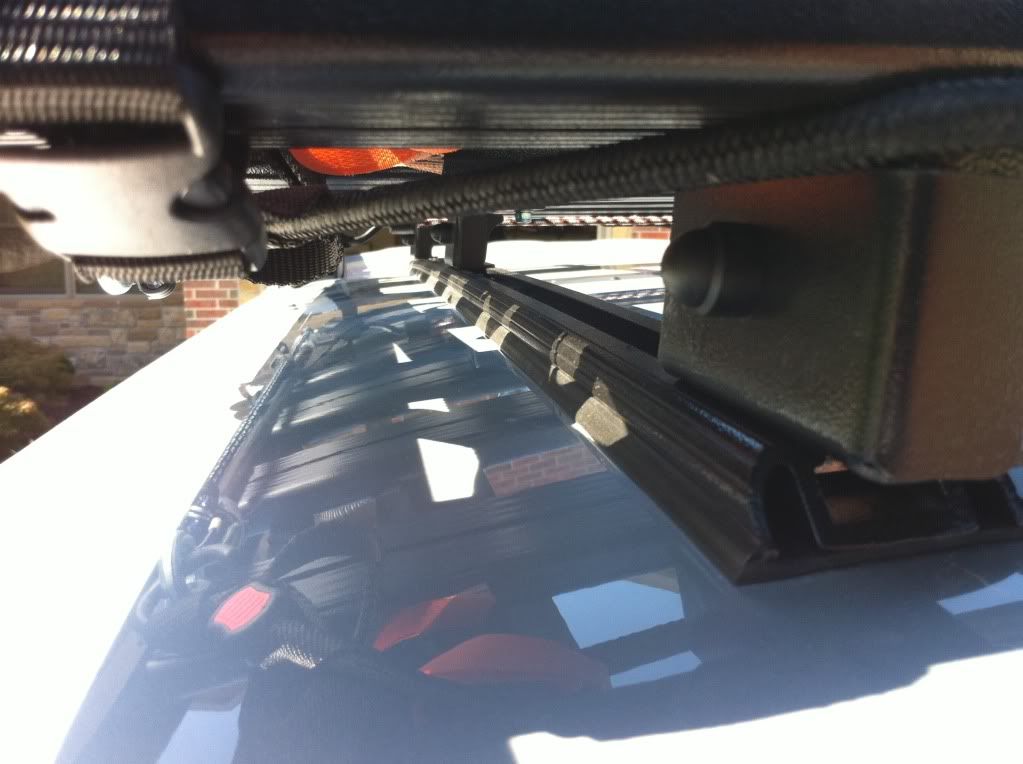

I was asked how the track was mounted to the shell so...
It's a proprietary track that was cut to length and bolted to the top (I cut the track a tad too short!)

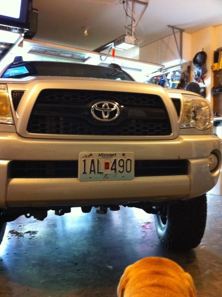

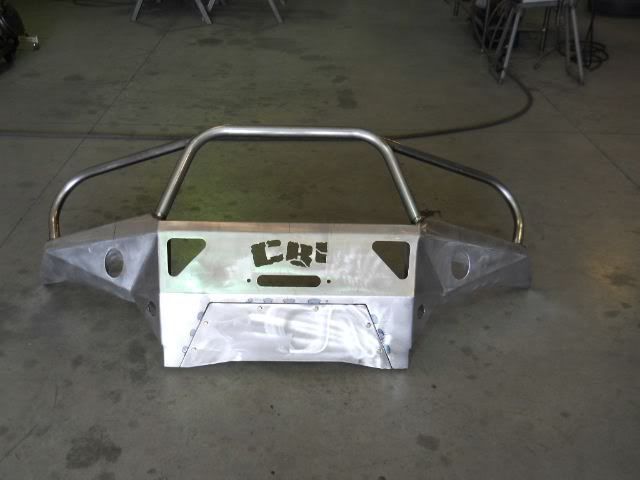

The CBI bumpers are at the powdercoaters so I should have them on by next week sometime- I can't wait. In the meantime I picked up a 2011 colormatched grille and decals for a change...

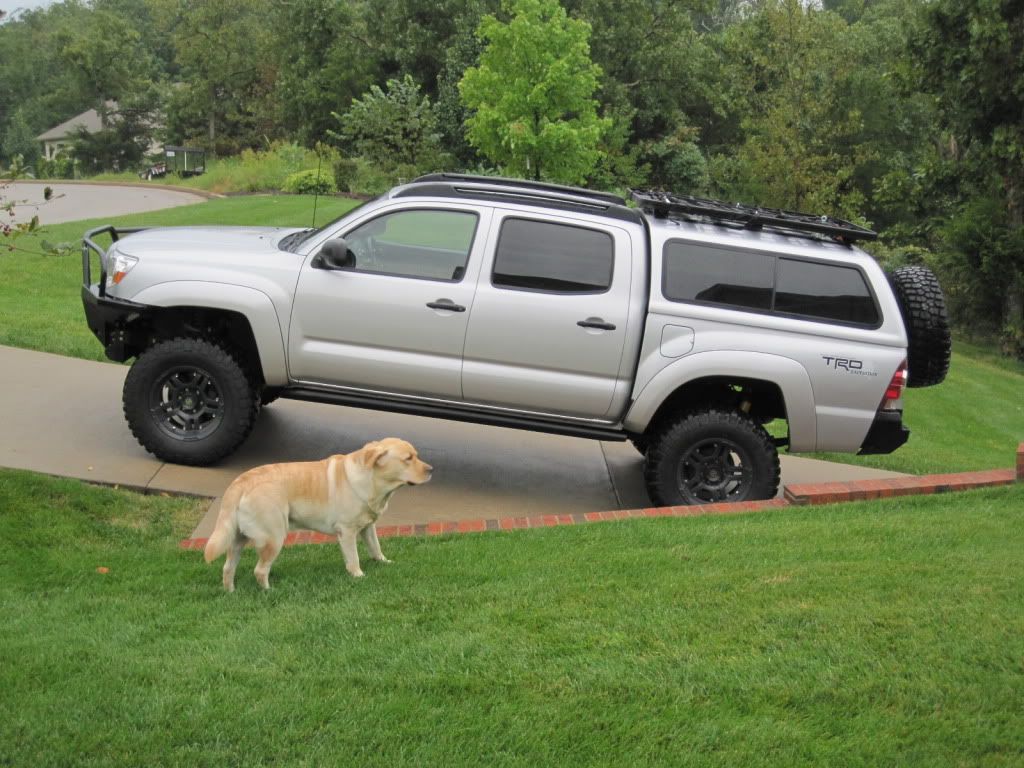

Thanks! I have a full OME lift, 886's up front and a Dakar leaf pack in the rear with an extra leaf. Shocks match. IMO the OME is ideal for low maintenance, high quality, solid 3" with weight for offroad lift. The wheels are ATX Artilleries with 285/70/17 KM2 BFG.

I originally had the 885's but they sagged too much. The ride is somewhat stiffer but not bad at all- no sag at all for ~2 years. The weight of my CBI bumper will soften it.

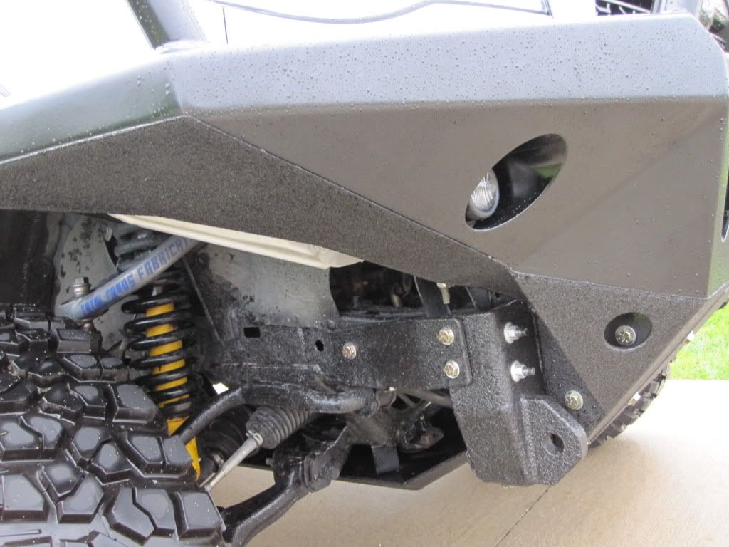

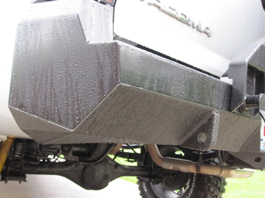

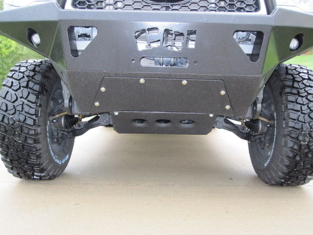

I finally got some pics. They are driveway shots again- working a lot lately! The bumpers turned out great I think. No issues with the install other than that mentioned. They are bulletproof! Here you go...
tomesd
Thanks guys- CBI sure can make bumpers. It's coming together but it's never really finished, is it? I put some Doug Thorley long tube headers on it yesterday as well- really woke it up midrange. It feels like a rocket with that supercharger!
