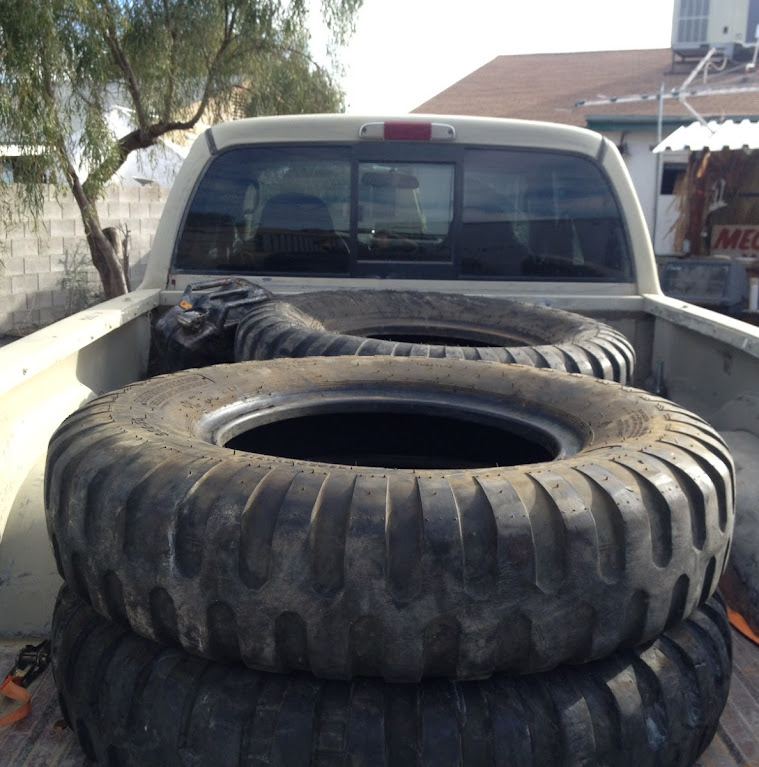

I also need tires, I can pickup some 11.00-20 Michelin XL's in a couple weeks. What are you running on your mog? looks like 11x20 NDT correct?
desertrover
External coolers have been fitted to 404 transmissions, but its added complexity for less than a huge gain. Temps with GL-4 should be around 230, definitely keep it under 250. The Amsoil synthetic claims to provide protection to 300 degrees, by which point a conventional would totally break down. The transmission is splash and capillary lubricated, and I believe the thin synthetic does a better job making it through the smaller passages while still providing sufficient lubrication. Make sure not to use a GL-5 oil in the transmission, as it may corrode the yellow metal plain bearings and be too slick for good synchro operation. GL-5 is fine for the diffs and hubs. Make sure your diffs aren't overfilled, as its a sign of leaky transmission output shaft seals.
I'm running 9.00x20 NDCC's, which are actually a few inches larger in rolling diameter than the stock 10.5x20's. "X.XX" indicates a 100% aspect ratio, vs "X.X" indicating 80%. The previous owner had fitted 11.00's thinking they would be only slightly bigger than stock, but a new 11.00 measures almost 44", 7" bigger than stock and enough to cause rubbing front and rear offroad and preclude use of 6th gear on level ground, limiting top speed to about 45mph. The 9.00's are relatively cheap and plentiful, and work amazingly well considering their narrow width.

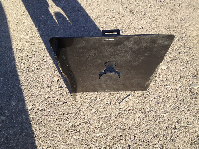

And I do not have a battery tray!
So I drew this up and I am going to cut it out Friday, it uses a ratchet strap to keep them in place.
Nick02
Here it is cut out, I got it scratched up already:) moving those batteries around was a PITA. I made it out of 3/16" it's pretty heavy lol
Tight fit in there, took alot of measuring to get everything secure and clear the terminals

Also picked up some used 9.00 x 20 NDT's for $50 each, taken off a m35a2 date code 2009

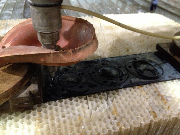

So I needed new tank seals since my old ones were shot and I don't agree with paying $9.08 for each one from expedition imports, so I modeled them with the interesting bolt pattern and cut them from a strip of nitrile rubber. Electricity, garnet and other factors considered I paid ~18 cents each:)
On the waterjet brick
The complete gaskets
And the Waterjet in action

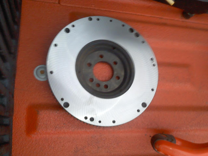

I was greeted with a exploded clutch, one of the arms on the pressure plate looks like it's gonna fall off so I spent half a grand to get all new parts, the spacer ring got lathed by the clutch but it shouldn't effect the operation.
New and old pressure plate
flywheel had some surface cracks and gouges so I got it resurfaced.
should have it all back together this weekend!
