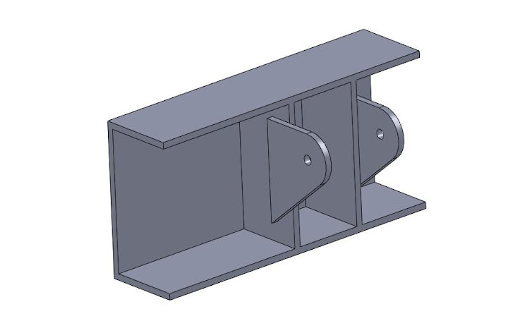

Metal for transfercase xmember

I pulled an np231 from an 200? something xj; it has the slip shaft that can slip out without loosing any t-case fluid, it's also 23spline:). Then I have to find a way to mount the Dana 24, allowing it to move linearly 3-4" in the frame before it bolts up.

My rear DS looks like it's gonna be 40-41" long, which is almost exactly the same as the rear portion of the two piece Dakota steel drive-shafts (you can see where the carrier bearing would bolt in on my useless cross-member in the pic above)
