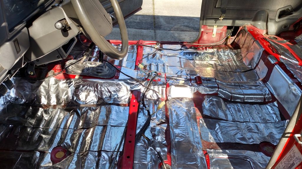

Today i took out the entire interior, that sat on the floor. Used Some industrial degreaser to clean. Then i covered the floor with a dynamat like material from home depot that is used too seal gutters and mobile home roofs. it is much quieter, and that was with no interior except driver seat with rear window rolled down. but i still haven't installed my new vinyl floor from jc Whitney and the rest of the interior that'll be tomorrow. Ill post up pics when its all done so hopefully tomorrow night ill be able too throw them on here. So the out come should be pretty good. now just need too find some aluminum sheets to make the side panels.

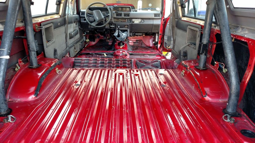

This is some good quality stuff. But the amount of custom fitment was way over stated. The bed area was just about spot on. but the passenger area on the truck required extensive trimming. After a grand total of approximately 10hours(I went above and beyond though.) My new floor was installed.

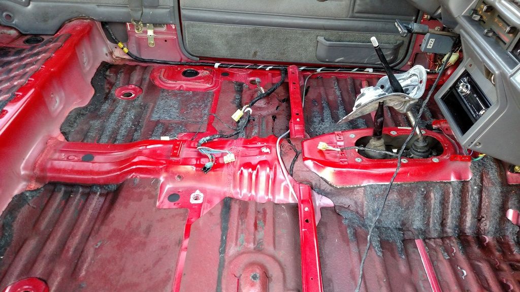

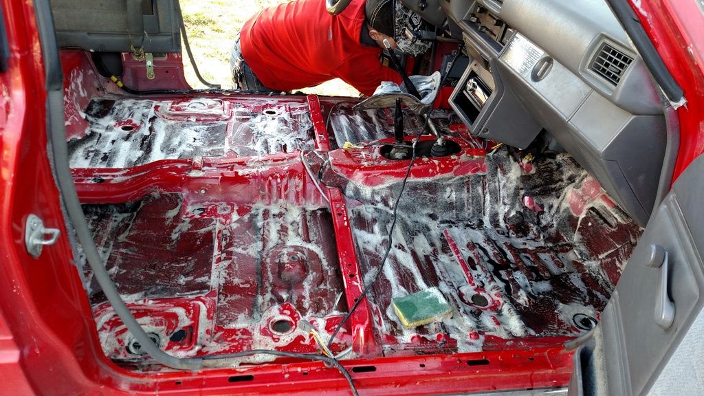

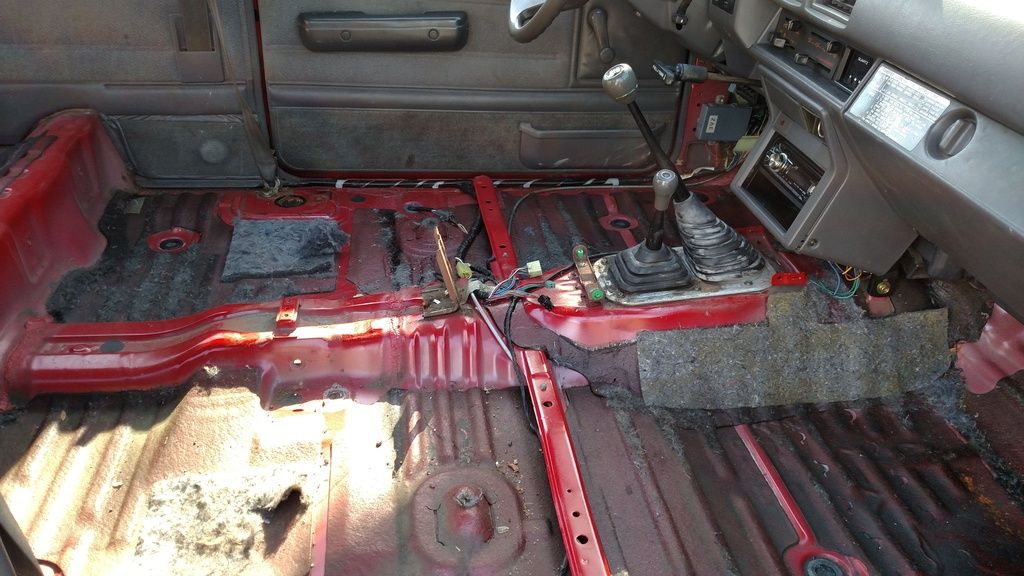

After ripping out the old carpet, I bought some industrial degreaser at Home Depot to clean and to help remove the insulation.
BEFORE
CLEANING
AFTER

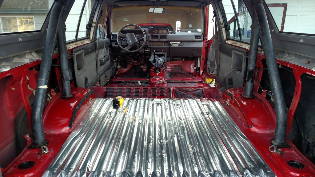

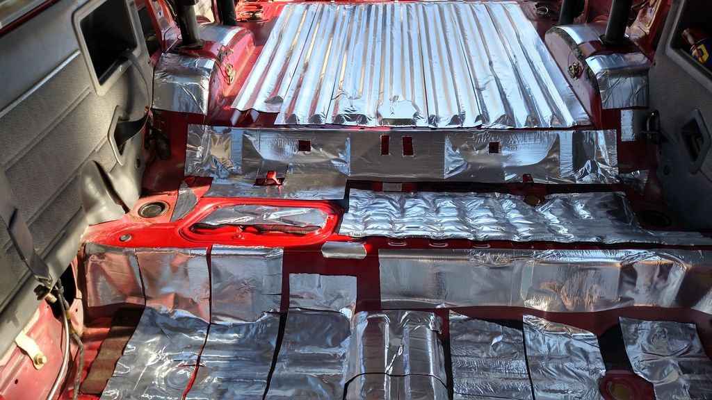

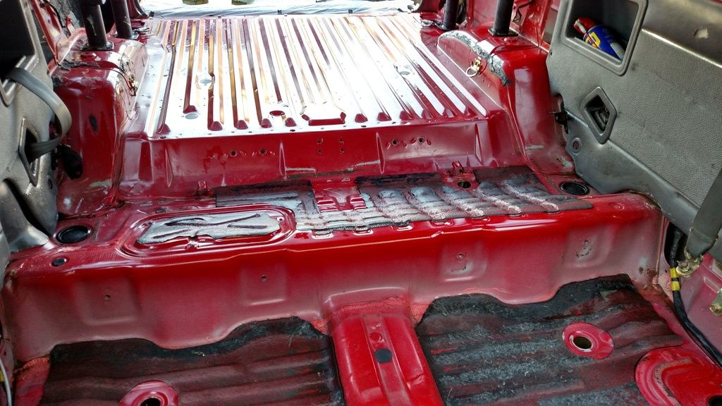

I let the truck dry out and then started laying out my new insulation I selected. Bought also at Home Depot for $16 a roll which is 6inx25ft. Ended up using about 3 rolls and maybe 3 feet out of a 4th.
Started in the bed
Then worked my way to the front.
