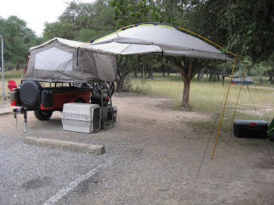

Wife picked up this sweet Kelty Car Port at REI on clearence..
I used some free legs for an awning on the tent side.
It rained on us this weekend and it came in handy to have the extra space.
I did end up cutting down the toung, its just long enough to clear the tire swing.
That looks like a killer set up right there... very sweet!:sombrero:
Was that at a local store or an online clearance?
JJonesee
It was at a local REI. I believe Kelty has a new model coming out, so this one is on markdown. This was also marked down again I believe.
It comes with two poles to set the end up. You can see here I have it laying on top of the Mombasa. It worked this way, but I didnt like the way it stressed the tent, so I found some legs for the front. Its a quality product. I would buy one at full price. I see it working on any vehical I have, and after it held up in a pretty serious rain windstorm, (in the lean too posistion) I am very happy.
Last week this was marked down to $219, and wife siad this one was 50% off of that. May check your local REI or give them a call.
