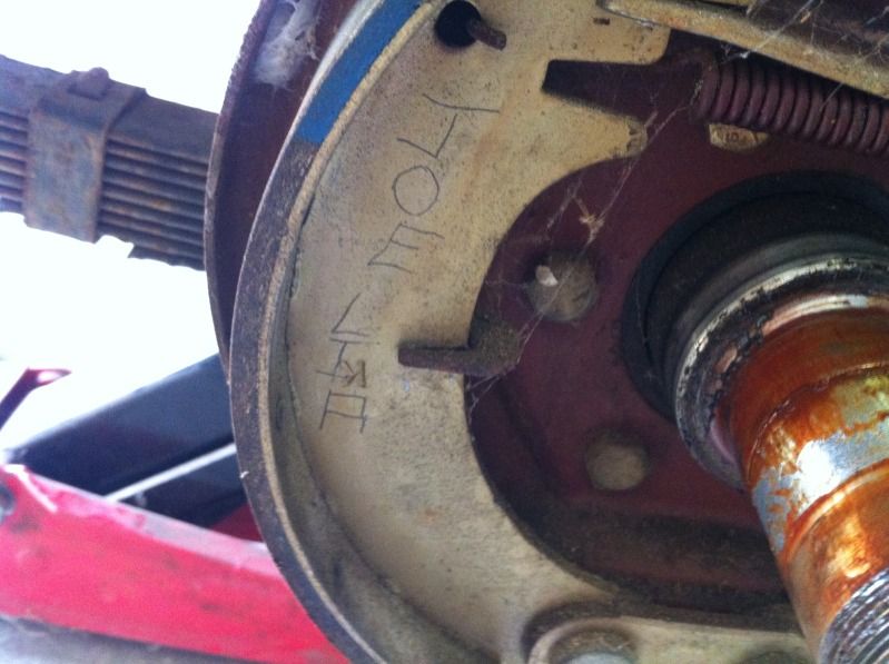

Whoever worked on it last felt the need to autograph it.

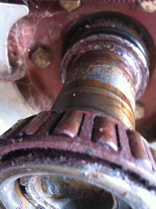

Oreilly Auto Parts had the bearings in stock. Had to order the seals

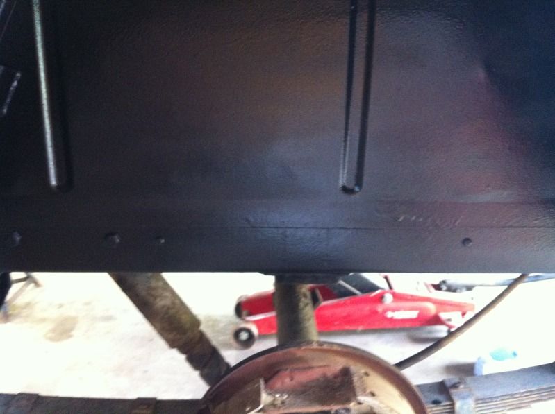

What a difference a little Permatex Undercoating makes. Thinkin of bedling the whole trailer. Opinions?
Little fresh paint
Hill Bill E.
Oath Keeper
Can't hurt. They take a beating from rocks and road debris.
I plan on doing mine underneath, the bottom inside of the tub, the front panel, and the front of the fenders, at a minimum.

I used Magnet Paints Monstaliner on my CDN m101 in the tub, and on the front of the tub (2 coats). I had enough left to do under the fenders and the entire fenders inside and out (1 coat). I used a low pile 4" round tip foam roller on the fenders, it turned out awesome. I wish I had done the whole tub with this stuff. Dries super hard, and I even primed and painted over the front tub liner to match the exterior.
If done right with not too much texture the whole exterior would look good. I also primed it all with POR15 before I painted anything...my new fav paint!!

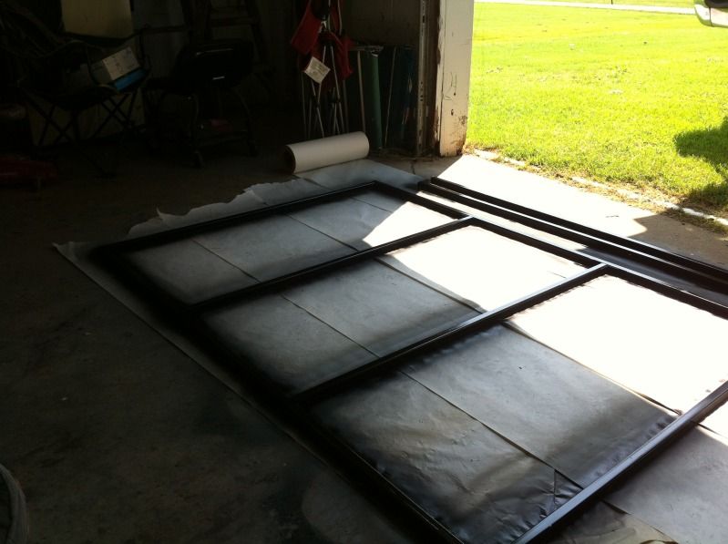

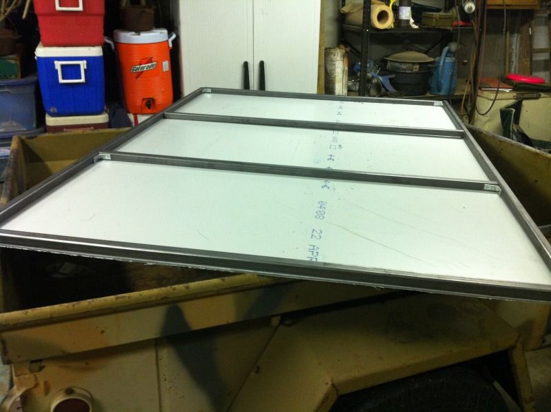

So, took a cpl days off work to mess with the trailer. Have 3 weeks this year and havent taken one day yet. That blows.

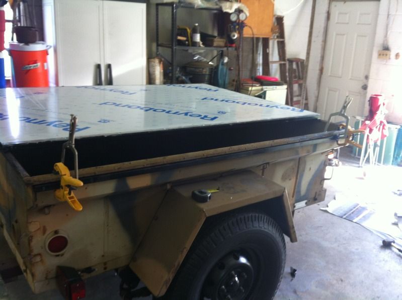

So anyway started work on a lid. Cant weld. Dont have access to someone who does and too tight to pay someone to do it. I think this will work though. Went and picked some 1 inch square tubing. They cut it to my dimensions. Then off to Lowes for screws, bolts, paint, silicone, L-brackets, hinges & hasps. Bolted the frame together using the brackets. Painted & siliconed before screwing lucabon to frame.

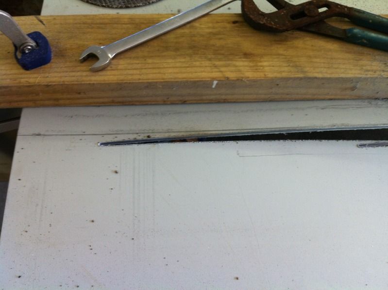

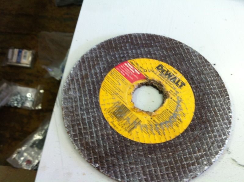

Jig set up to make cut to lucabond and try to stay square
Oops
Ha. Not my fault. Blade gave up
Setting side piece to mount the hinges to
He says "Dude, arent you done yet. Im ready to go."

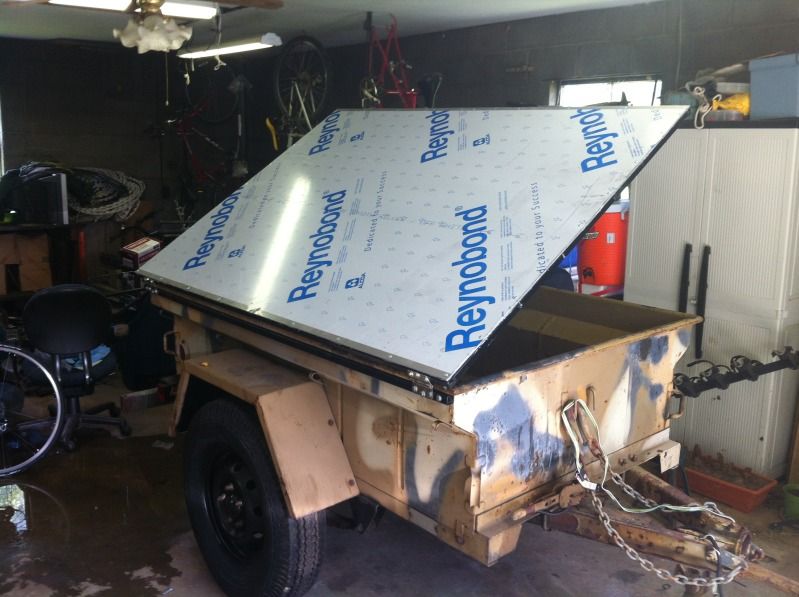

Hope to get the hinges and locks done tomorrow. Then thats all for quite time til other funds are availabel.

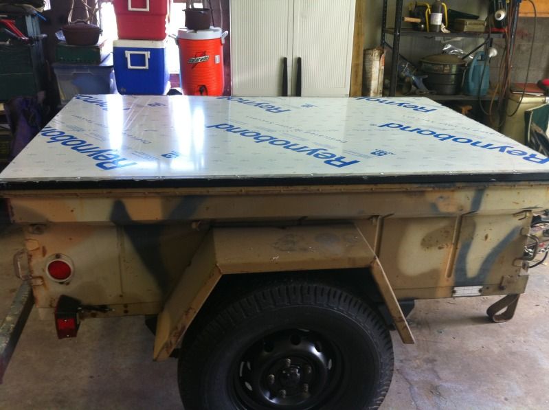

Lid is alucabond. Well I got very lucky. The piece I have was leftover from a job a guy was doing where I work. It was exactly 51 inchs wide and just a little too long. The length is the only part I had to cut. Blade went thru very easy. Its a little softer than I thought. When I attached to the frame with screws they pulled into it some which is ok. Gonna screw to the center braces as well just to make it more ridgid.
Your trailer looks good. Im thinkin of bedlining inside and out of mine as well. I kinda hate to put it over the lid though as it is a nice silver grey color.
chasespeed
Looking good.... I would get it all squared up, and find someone to buzz that all together once you are happy with it.... just my 2 cents....
