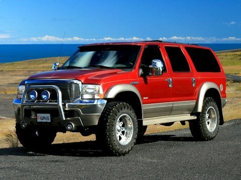

For size a diesel Ford Excursion would be perfect for what you are wanting. They can be found in the 15-25k range. Which leaves plenty of room for improvements. I've seen reports of them getting 900 miles on a tank.
Down sides,
I've had one. I remember driving on the forest roads around our property and several times smacking the diff on some rocks. So I think a lift would be in order, with a set of good taller tires.
Probably would be just at size restrictive on the trails if not more so than your sportsmobile.
I also remember that the 4x4 system was finicky, it has the turn dial electric selector. And I remember several times 4x4 just would not engage, or it would light up without actually engaging. Not sure if that is a common problem or if I was "lucky".

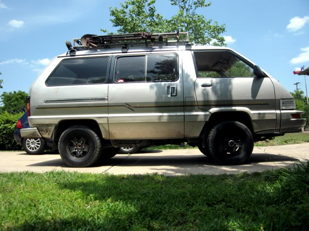

modify an older Toyota 4x4 van.

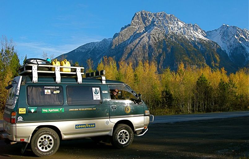

If it within your possibility to import, A mitsubishi delica factory diesel, 4x4 high/low and diff lock, lots of room. There are lots in Canada just watch for rust. Not sure about the range on these. (also the 4gens are built on the pajero/montero so capability is there and parts availability around the world. However engine parts in the US may be tricky if you go for the diesel.
