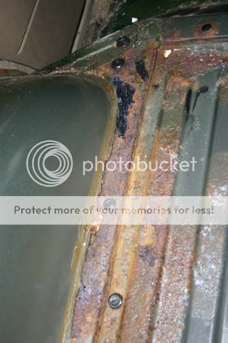

You may want to check the alpine roof seals these are notorious for leaking, the water runs down the panel then under the stupid rubber boot floor liner and never evaporates, you can't tell the floor is wet because of the stupid rubber liner.!
yours look ok mine had almost completely separated after I put a couple of 50kg bags of pony nuts on it, I sorted the leaking seal with "capt tolly's creeping crack cure".. top stuff.!

mine looked like this...

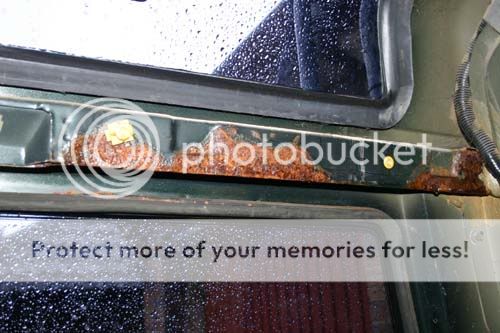

And mine leaked from here:-

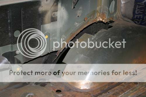

No sunroofs, no water from safari windows, it just got into this beam somewhere, ran to the back, ran down and made the floor wet, and the sound proofing did the rest.
!0 days of grinding, cutting plating welding and painting resulted in this:-
The whole lot was then finished in black Hammerite, should last a good few years now.
