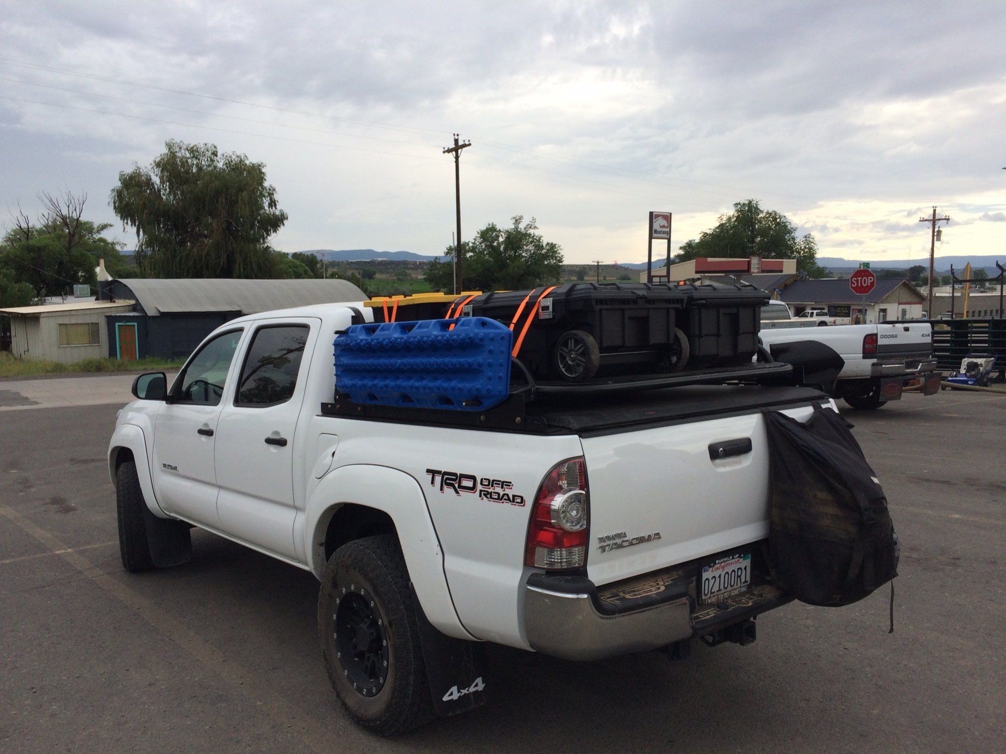

Hey guys, I'm in no way a fabricator so I could use some advice from someone who is more knowledgeable. I trusted a buddy who is a professional fabricator to build me a rack, well he took my money and gave me half of what I wanted and half mediocre last minute work. The tray itself is well done, the tubing is bent, notched, and welded great. The mounting plates are the wrong spec, about .25" too wide on either side, and poorly made (there isn't a single square corner on any of the plates), its a miracle it fit at all. The maxtrax mounts are shotty at best, I was afraid I was going to see them go flying on the freeway.
Here is the rack in question:
attachment.php
attachment.php
attachment.php
The issues:
  • Mounting plates are sub-par, not square, misaligned, and have bad cuts
  • Maxtrax mount is sub-par at best and one size has already broken
Basically to get this up-to-standards I need to rework the mounting plates and come up with a new mounting solution for the maxtrax and shovel (its mounted on the right side mounting plate). Is such a small change in width even manageable considering I'd need to cut the plate off? I don't think the maxtraxs will be a major issue, some angle cut C or L channel should be fine, but I'm concerned about the mounts. My experience is minimal at best, I have a welder and angle grinder but that's about all of my access to metalworking tools. Would this be a simple job for a shop or am I trying to fix a lost cause? Any advice from someone who knows more of what they're doing would be greatly appreciated.

your photos don't seem to show detail of the "mounting plates" and how they are out of square. that would be helpful. did you give your buddy specifications, or just a general idea?
Kiriesh
I didn't include photos because its unrelated to what I'm trying to do. Not that it matters but I gave full specs accurate to 1/16". The larger issue is that the entire rack is about 1/4" too wide. It was sheer luck that it fit, as it was designed (or at least it was suppose to be designed) to mount on the inside of the bed rails, but it was close enough that we were able to fit it on the outer side of the bed rails, with some pressing and swearing.
NatersXJ6
hmmm... without seeing it up close with you there to answer questions, I probably can't help you. in general, a 1/4" difference could be introduced in a prototype fab through lots of errors, twist, thermal stress, measurement error, etc... the question of whether or not you want to chase it out comes down to $$&. I can't recommend any specific shop, but in general, I think cutting something off and re welding isn't impossible

I guess I'm probably not being clear with what it needs. I'm not afraid to clean it up and round off edges if need be, but the brackets aren't oversized. The whole rack is about 1/4" wider (side of the bed to side of the bed) than it should be so it doesn't align with my bedrails properly. Each bracket needs to be cut off, the support bars(? or whatever you want to call them) need to be narrowed, and the brackets or new brackets need to be welded back on.

It sounds like you really got screwed. That sucks. The challenge in narrowing that by 1/4" is that you need to take 1/8" off each side. That is only the thickness of a cutoff wheel, give or take a bit. You might be better off to remove the entire mounting bracket and build new from the tube out. In either case, I think you are probably building new mounting ends. You will be better off to build them free, bolt them to the truck, and then clamp the rack in place while they are tack welded. That way you ensure alignment and fitting. It won't be easy, and probably not cheap. You might also consider replacing the deck material with flattened expanded metal, it is hard to see from the pictures what was used, but it doesn't look great, and you described it as aluminum sheet screwd down? Not very durable in my opinion.

yeah, your description wasn't clear it appears to be mounted on your vehicle, with your gear attached. So it would seem that the tubing structures themselves work and that your issue was the crudeness of the footing / mounting plates. That's why I suggested trimming them up.
If the tubing rack itself is an acceptable size then yes, just cut the feet off and make new replacements. If the tube rack itself is too large then just cut it down the midline / in half, removing the extra width there, and bevel and butt weld it back together.
I'm confused by your seemingly thinking there are insurmountable problems. What can be made can be unmade and re-made. It's really not that difficult. Even if it seems it was too difficult to get it right in the first place. Your 'precision' experiences may be skewing your perspective in an unhelpful way. It's a shame you got screwed. As you say, move on and get busy working the problem.
maybe start with photos or a diagram of what exactly the trouble is, so you can garner better suggestions for fixes.
