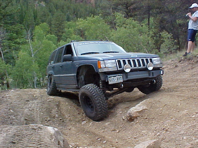

Pic of mine. Lots you can do!

^ wow your zj looks great. I'm still deciding on what brand to get for my coil space lift. I'm pretty sure I will get the kit from the rubicionexpress website. Thanks for all the info.
