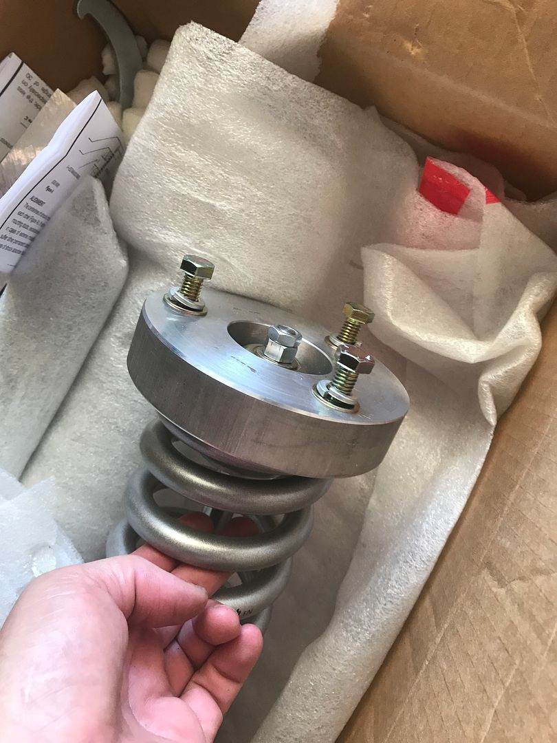

Anyway, when I got home, I found a picture I took when I received the coilovers.
There is a jam nut on there, but for what ever reason, both sides failed in relatively quick order. Bad design? Poorly assembled? I don't know.
So, if you or someone you know has these, please check the nuts on top of the strut shaft regularly. If you're thinking of buying these, I'd think again.

Seems like the root issue is the mechanic who assembled the coil overs failed to use a locking or jamb nut, lock washer and/or Loctite? Normally on 5100s (or similar shocks) you'll see at least a nyloc nut at that position.
The shocks appear to be standard Bilstein so as long as the shafts weren't damaged once a proper approach to retaining the nut is done there's no reason necessarily to mistrust that they'll be fine now.
That nut is a good thing to have on your list during pre- and post-trip inspections although it's not normally something you see backing off. It is a critical fastener.
That nut is a good thing to have your list during pre- and post-trip inspections although it's not normally something you see backing off. It is a critical fastener.
Good luck and be safe!
Definitely a place for red Loctite.

I'm thinking of using a nylock nut for the jam nut if there is enough thread. Will do the loctite if that doesn't work.

In his defense, this is NOT a failure of the shock or the coilover design. It actually looks like a solid design. It's a failure of the hardware. In YOUR defense, there's absolutely zero reason why this had regular nuts used instead of nylocks or at minimum lock washers. I have no idea why anybody would think that's a good way to put it together. If it were me, I'd take the shock to Ace and find a nylock or all-metal lock nut for the shaft, figure out a washer combo, maybe add a lock washer, and be done with it. I'd trust the shocks fully, but they need a locking nut of some fashion to be safe.

All good points on the coilovers. One side has a regular nut and a nylock. If I can make that fit on the other side (currently two regular nuts), I guess I'll go with that.
