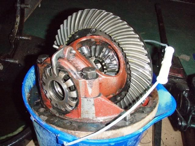

So far, I've got the rear diff off so if anyone is interested in a stock Rover 10 spline Diff let me know. I'm going to be getting rid of the whole axle housing. I'm going to have it sand blasted and cleaned up though. Whoever gets it will be a step ahead.
