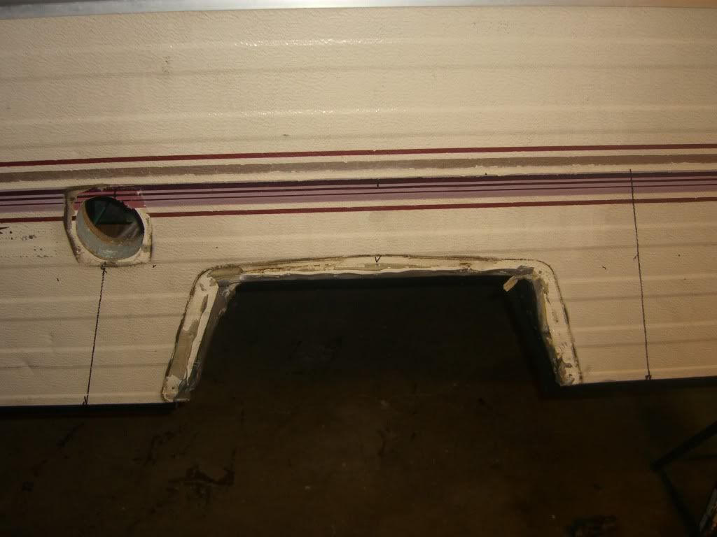

I have been thinking for some time now to put bigger wheels and tires on my trailer. I finally started yesterday by cutting the fender wells out and making the room for 31's. I have purchased new hubs so the trailer lug pattern and my truck are the same and the wheels will be interchangeable.
Here are some pics of the progress
The beginning
Need more room
http://i605.photobucket.com/albums/tt136/39ranger/Big Bear April09/Tent trailer/TentTrailer004.jpg
Measured and marked for the cutting
http://i605.photobucket.com/albums/tt136/39ranger/Big Bear April09/Tent trailer/TentTrailer006.jpg
After cut
Tire Fit
http://i605.photobucket.com/albums/tt136/39ranger/Big Bear April09/Tent trailer/TentTrailer012.jpg
Next. I just picked up the sheet metal to start forming the inside fender wells.
For my question:
I am planning on going away from the solid axle torsion style suspension and going with a independent swing arm, bagged. I have seen some pics of this done but am wondering how to determine the length of the swing arms and if 1.75 round tubing .120 wall would suffice? Also trying to figure out what shocks and bags to use.
Original axle was rated at 1500lbs although I am sure it didn't weigh that much. I am going with spindles and hubs that are rated at 3000lbs just for safety. I will be adding some weight to that trailer by boxing the frame and adding some exterior protection.
