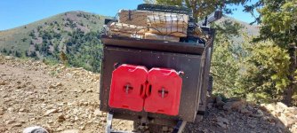

XO jack in action. We got trapped on the trail because of a tree drop blocking the route. I didn't have room to turn everything around, so unhitched and spun the trailer right around. This would have been a big workout with any other trailer jack, love this thing.
Same thing happened to me 9,800 ft up in Utah's Henry Mountain.
