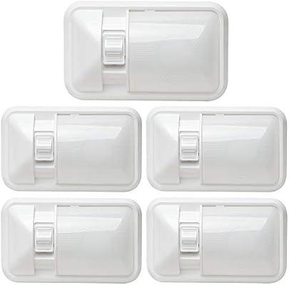

I ordered the new low-profile galvanized roof vents, but haven't installed them yet. Also ordered a bunch of LED light fixtures. Singles and doubles.
But OMFG they are enormous. I didn't even notice when I ordered them. The singles are 8"x5" and the doubles 11"x5".
It's not an issue for the doubles as they are all in the front and on flat surfaces with lots of room. But the singles are too wide to fit between the upper cabinet doors in the rear. Which is fine actually...I'm going to mount them facing down on the bottom of the cabs and leave the originals in place for now until I find something suitable.
Same in the head. There is already power in the ceiling for the vent, so I can use that the install a double up overhead. And eventually find something to put in the original vanity spots.
In the front over the dinette, on the bottom of the overhead cab is a double, which a switch by the door turns on one half of. Haven't decided yet what I'm gonna do there. I'm thinking a double over the dinette, then pickup that extra wire and put a single nearer the entry to give more light on the steps.
