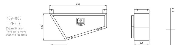

The boxes they put on the rear leave a bunch of wasted space. Ask for the ones below, about an inch or so narrower but more length, tell who ever the sales person is that “Yes they’ll fit, Yes you can order them, here’s the number”
