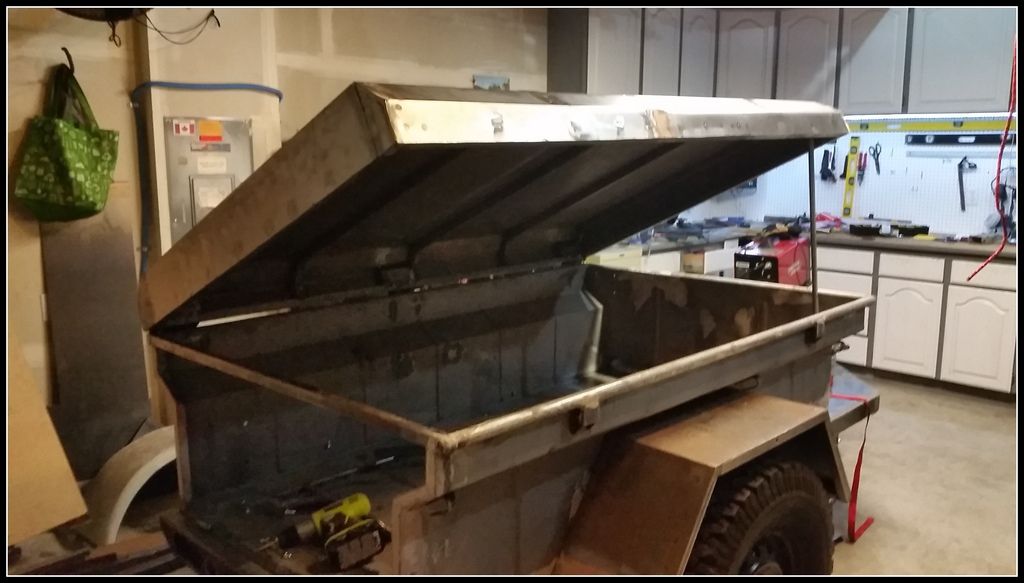

Knee got little bit better even though it has to undergo a surgery in a month. wasn't able to sit idle so got into garage to get some more work done. I am doing it little bit slow for the obvious reasons.
I got the Hinge mounted. Before mounting it i place the weather seal that i am going to use to account for any clearance issues that might make hinge not to work. All my hardwares will be coming in next few days. so i just used what ever available in my bins to do the test fit.

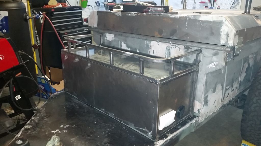

Priming in progress..
